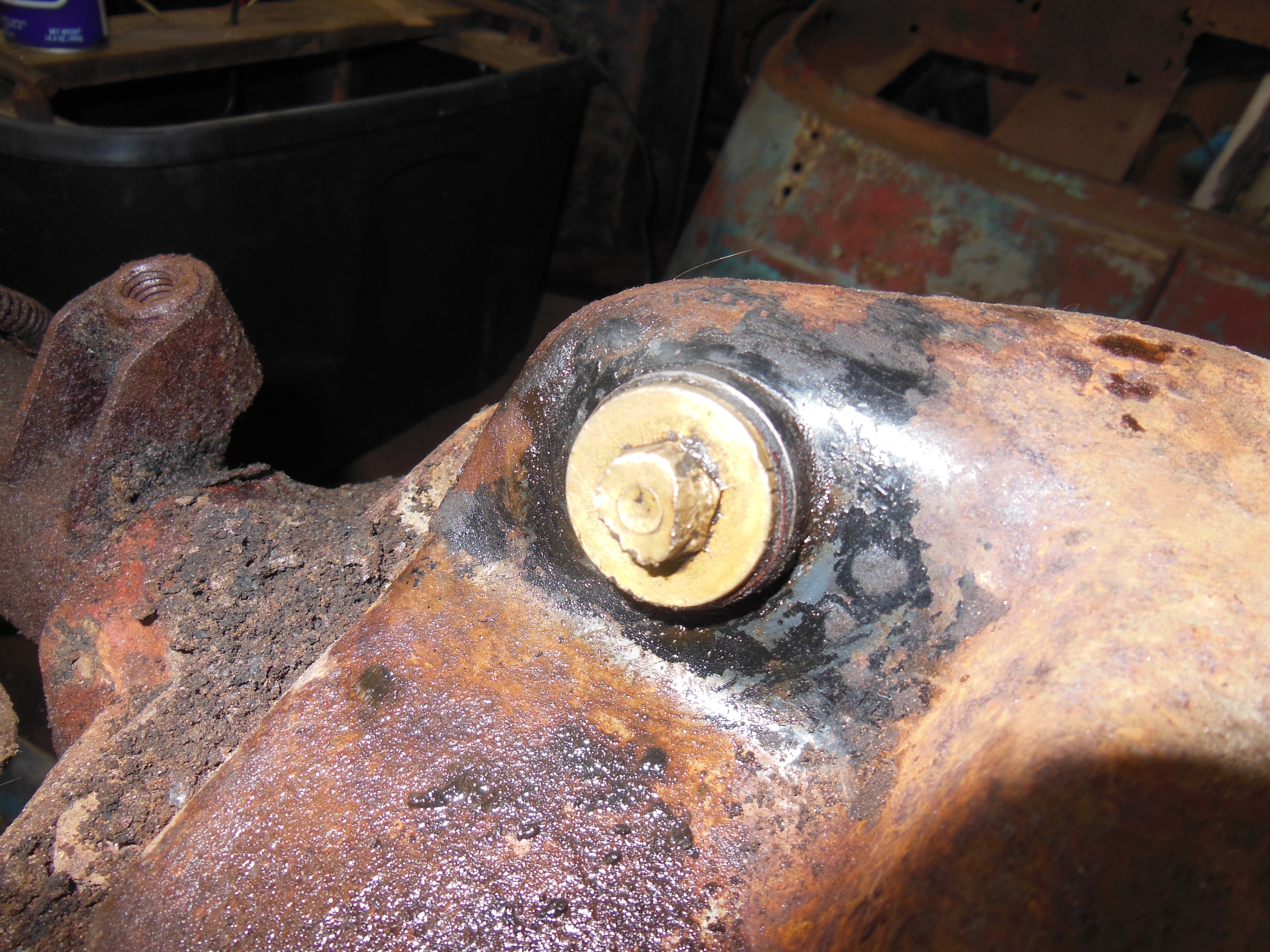

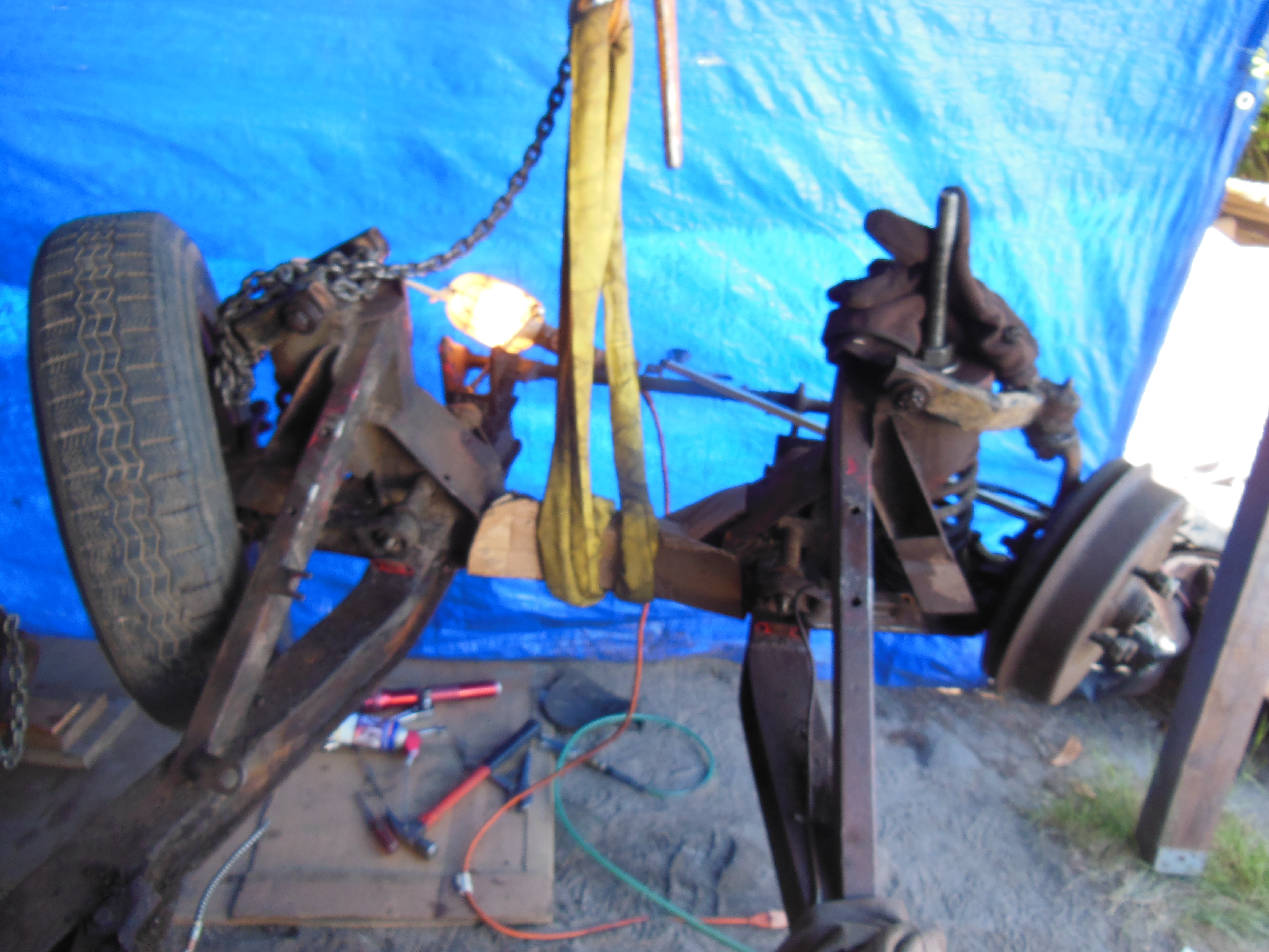

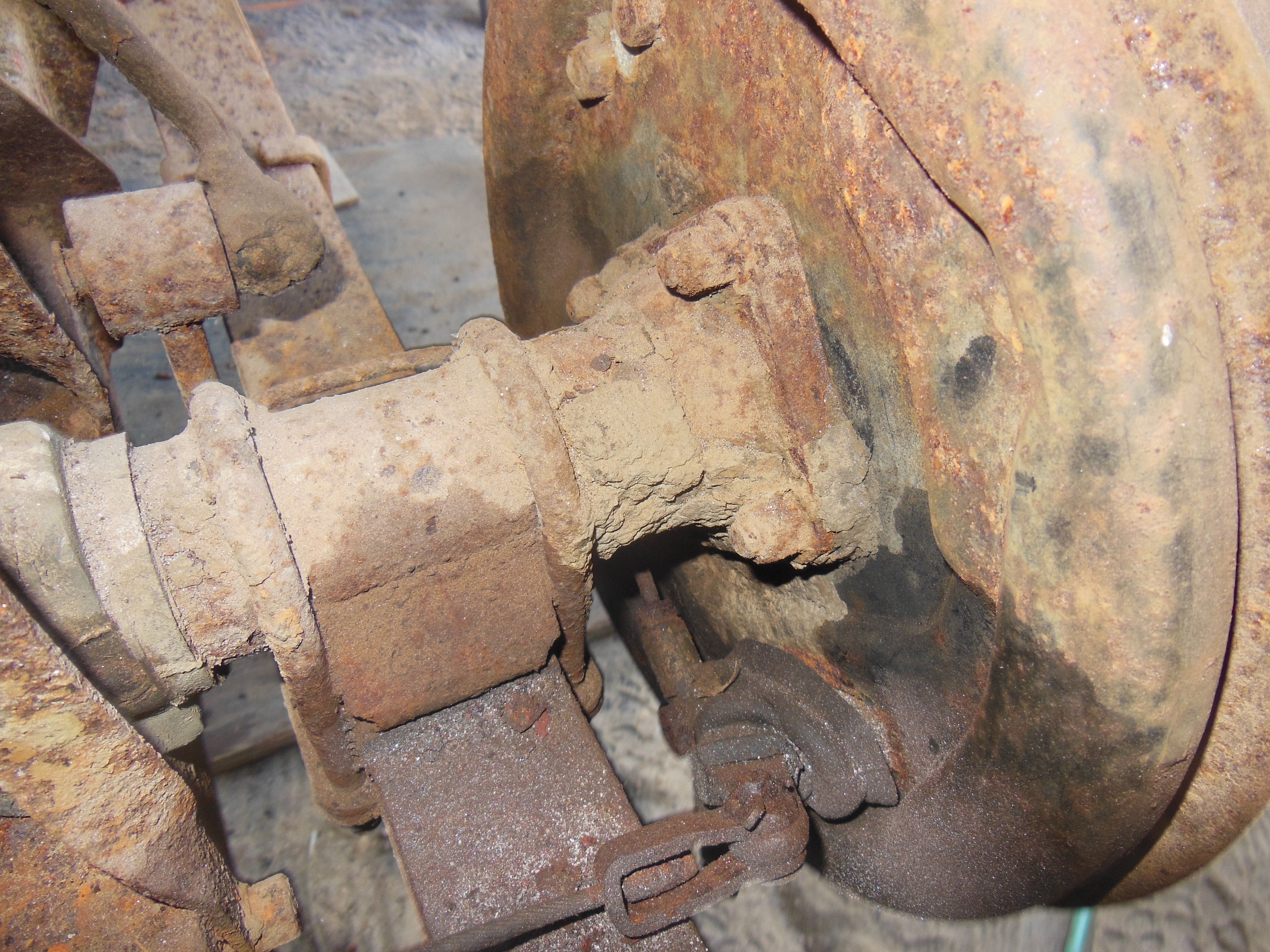

sp53

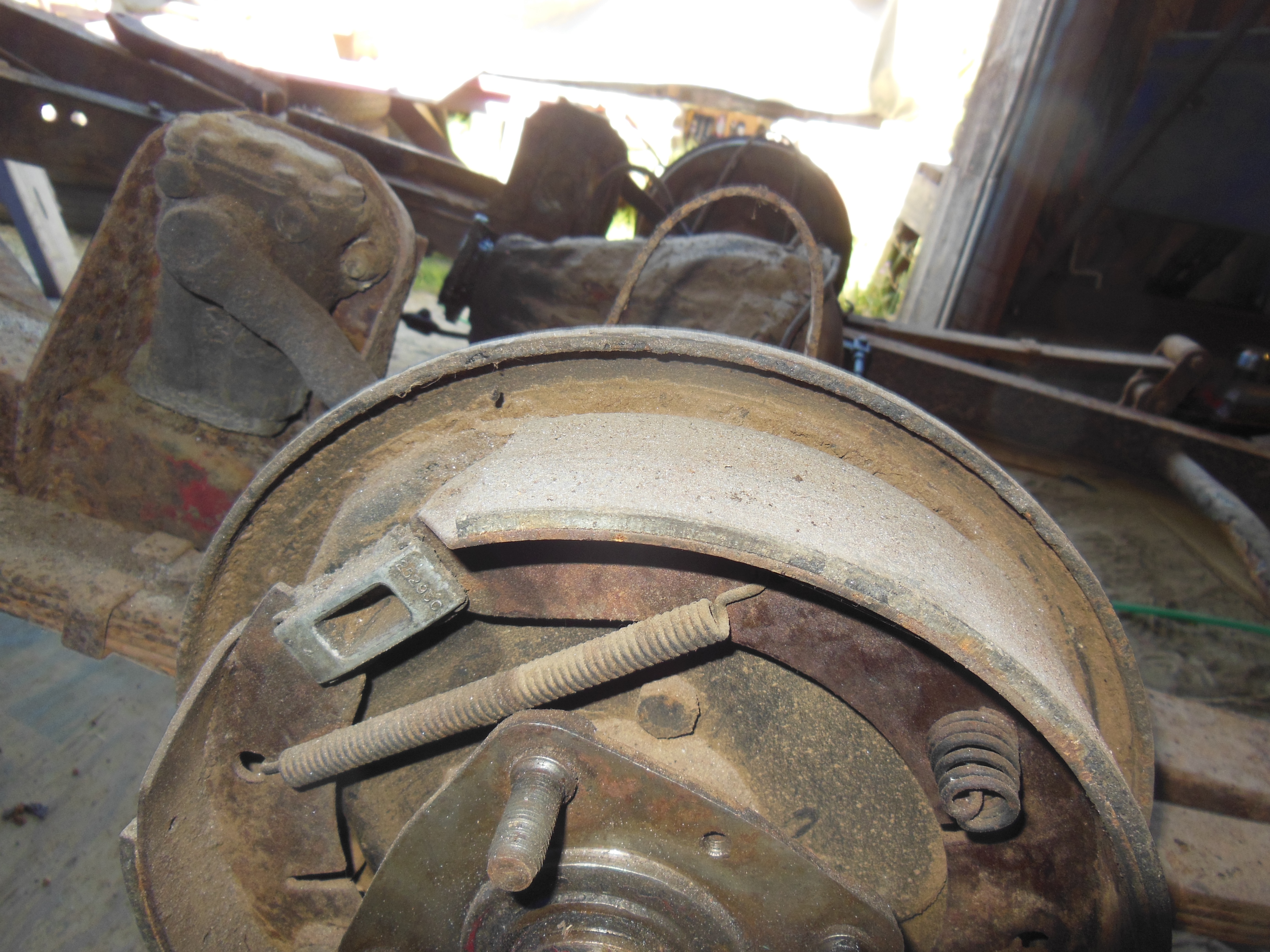

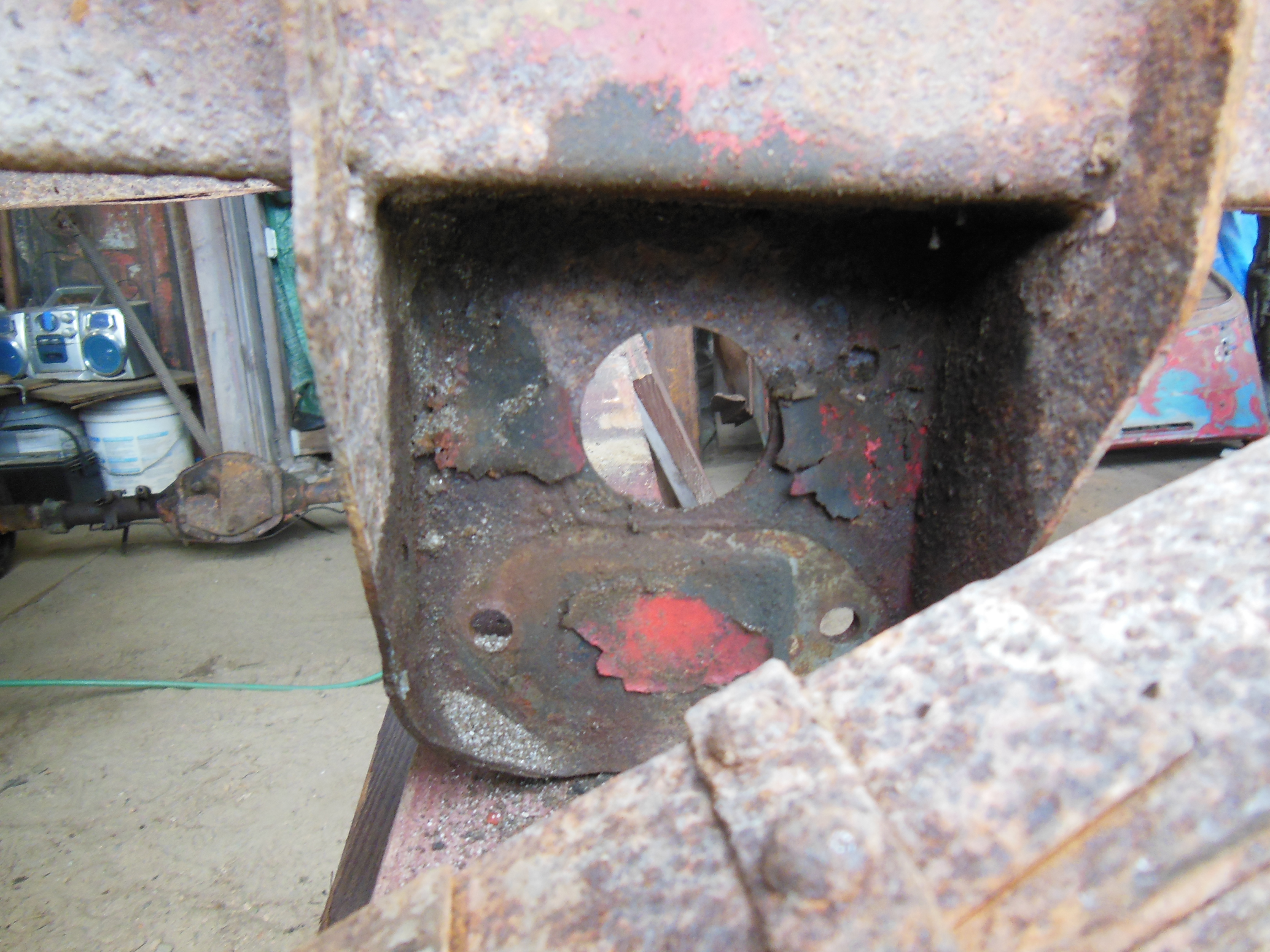

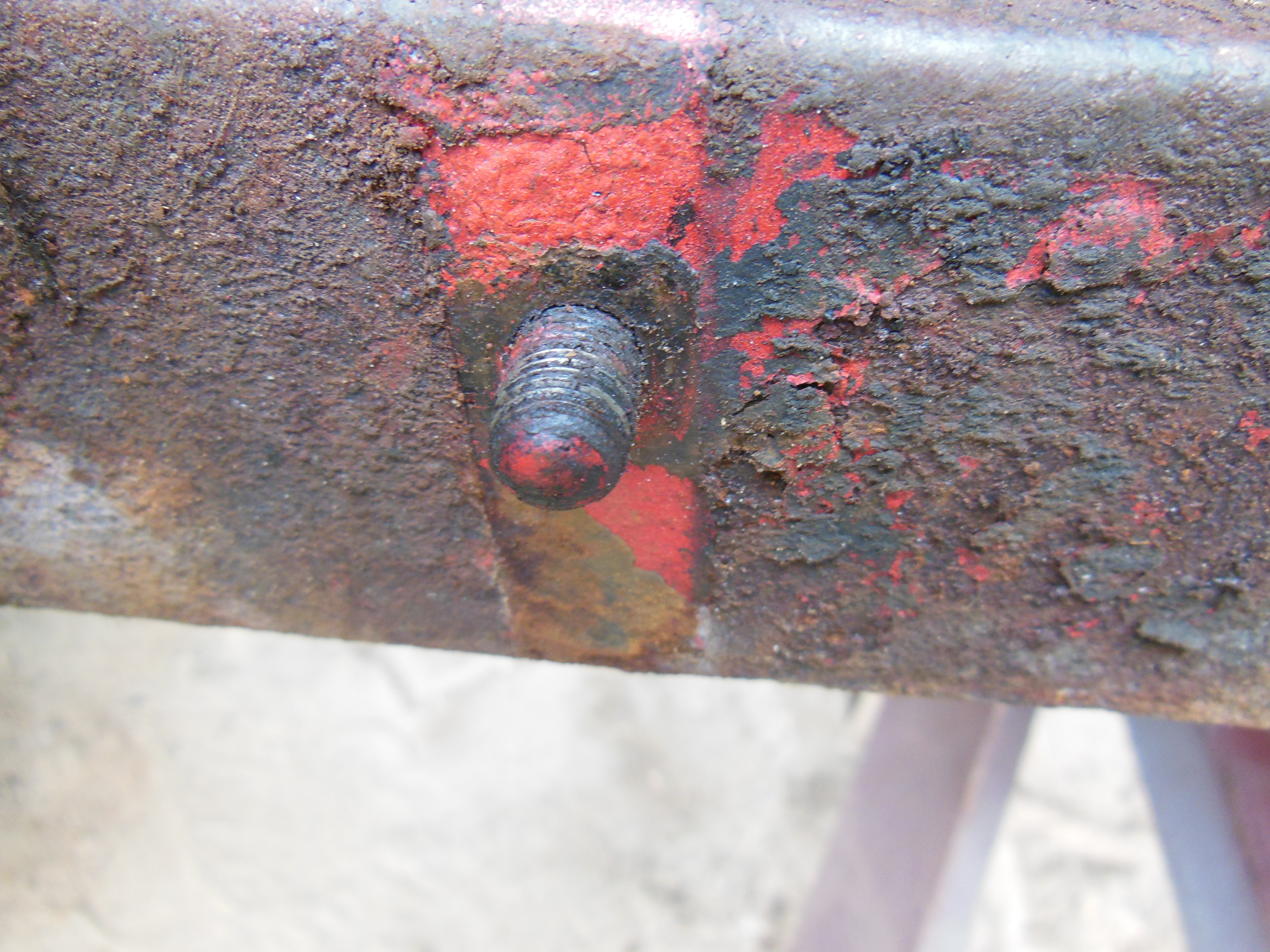

Thanks John I am glad to hear the older axel was built a little simpler. Does yours have that brass fill plug or is that something the PO put in. After taking this car apart, I have been analyzing the cars running history. Somebody put new brake shoes all the way around and a new clutch. The drums where half buried in mud which hardened to the drums. I took one of the drums and put that into one of my rust dissolving tubs for 4 days and all the mud and rust fell off. The drums look good, but I will need to have them measured. I want to get the rear axle and suspension back on the frame first, so I can move stuff.
The car had a red frame, so I will paint the frame red.
Steve

CJD

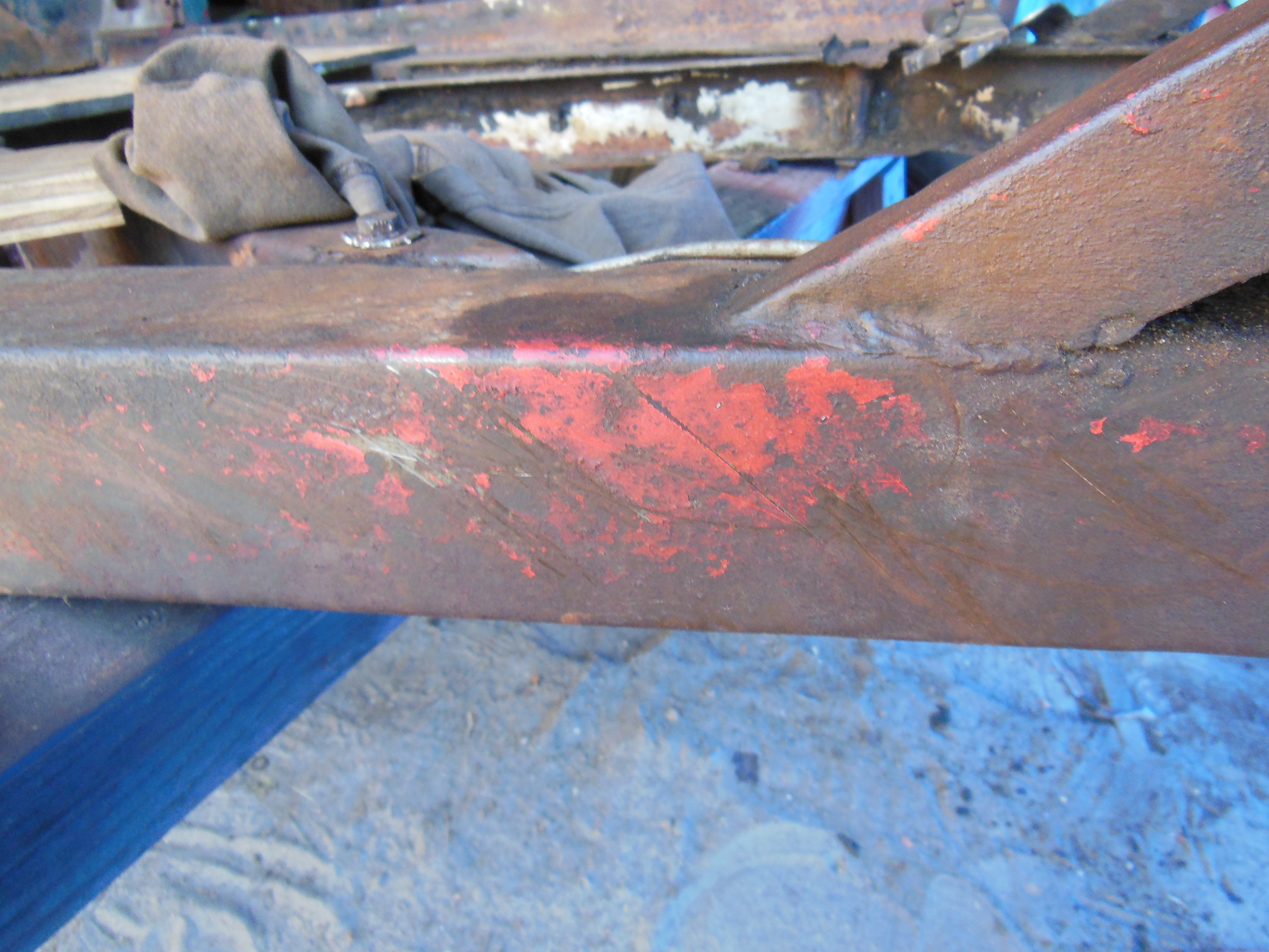

A red frame is pretty cool! And, it's definitely red in areas that were likely not repainted. Your frame looks to be dirty, but no bad rust through at all...also cool!
Yes, the TR2 used brass plugs for the diff cover and engine oil drain too. I see you have the original 4 wheel drum brakes. I have all drums on mine, and they work great (when dry). I was worried because I remember all the drum cars darting a bit in the 1960's when you first applied the brakes. But the TR2 brakes work great and no darting at all on application.

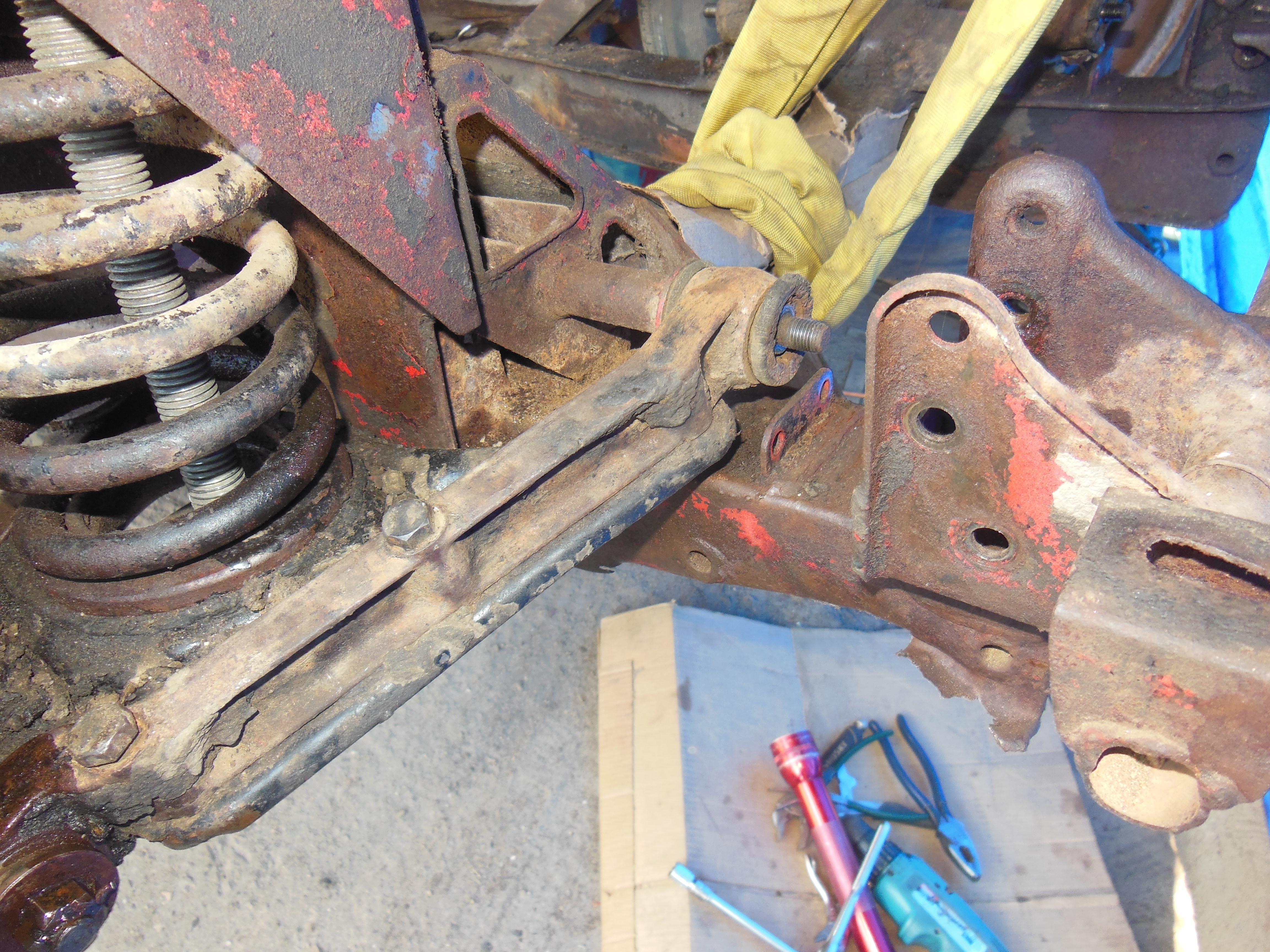

Yes the frame is in great shape in some spots and rusty in others. There are a couple of spots on the frame horns that need attention. When you rebuilt your front suspension, did you use the nylon bushing on the lower arms or go with the rubber bushing. I am leaning toward the rubber because that was stock for 1955, but I can see the nylon would be better. Hopefully, I can get the front brakes finished with shoes and rebuilt or new brake wheel cylinders. The wheel cylinders in it might clean up and it looks like new is available.

I went with the newer, nylon, that comes in the suspension kits these days. I see no problem with the original rubber bushings, if you can find them. Mine were still in place when I rebuilt mine.
