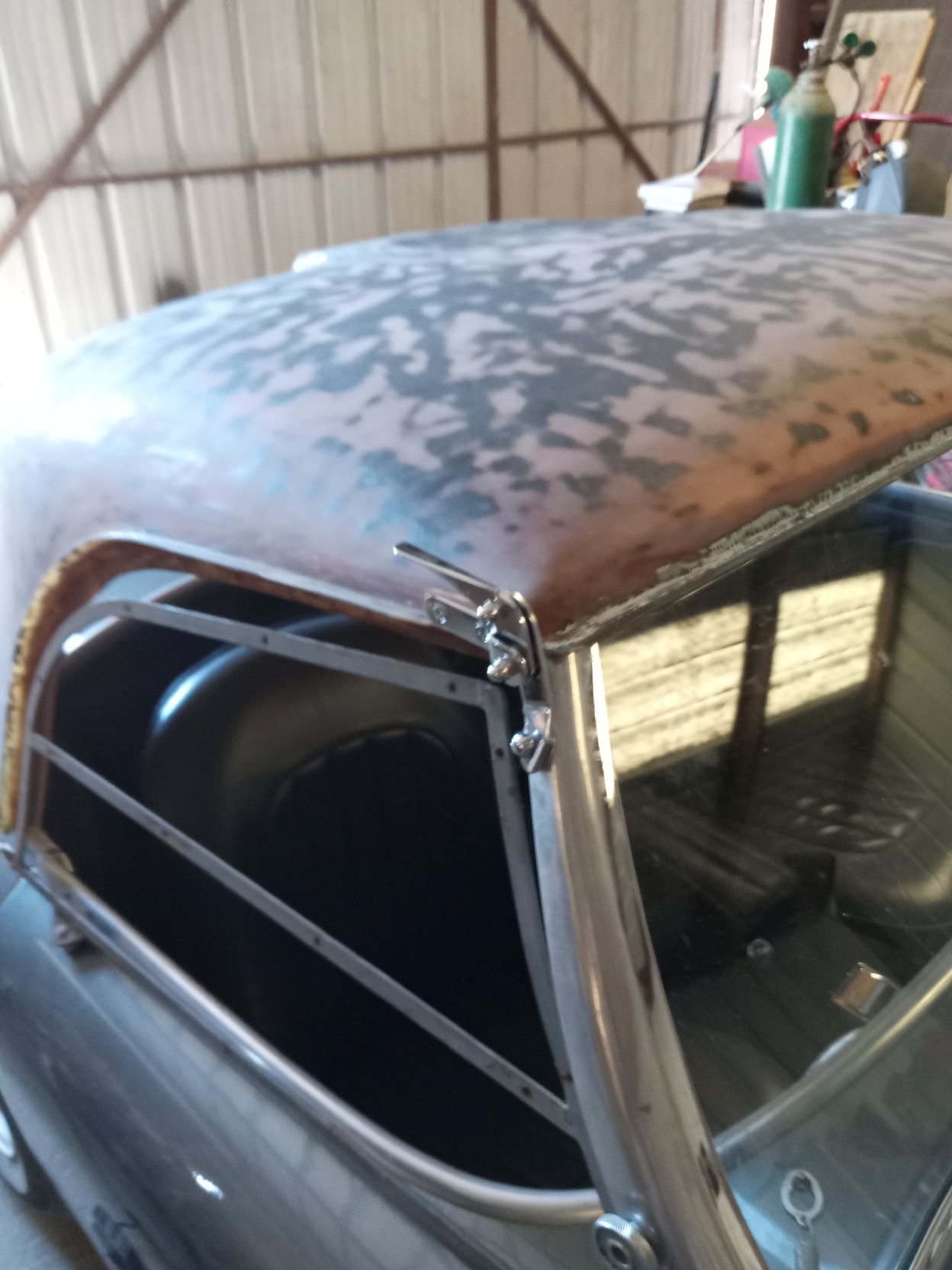

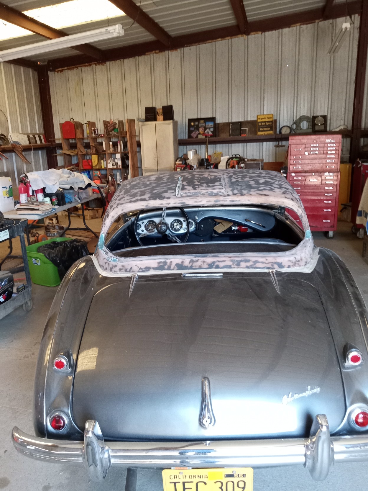

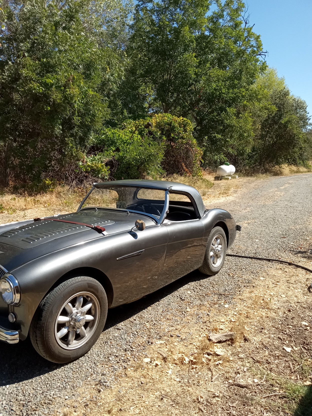

Years ago I bought a bunch of Mowog tools from the guy I bought my BN2 from. He had a 2 place hard top sitting outside and wasn't even sure if it woud fit a BN2 but knowing hard tops were valuable I gave him another hundred dollars for it. It was made by Plastic Dynamics which was in Southern CA. They are not in business as far as I know. It sat gathering dust as I had a soft top. I suspect it was a BN4 or later 2 seater top. I finally decided to see if it would fit. Not only does it fit with a tiny bit of trimming, but I'm able to use the same front clamps that are used for the soft top. I didn't think it was particularly attractive but when I sanded it and did some fitting it kind of grew on me. I have about an inch of head clearance but that is no different than the soft top. Has anyone seen a top made by these folks ? The rear window looked awful but with some buffing looks great save for one scratch I may yet buff out. I haven't decided how I'm going to finish the inside but will probably just glue in some sort of stretchy material that I can shape to fit without bunching or cutting. I'll paint it to match body color, although black would look ok as well. As with my soft top I'll use the same safety cable at mid windscreen. By the way, my shop has never looked so tidy.......

Thanks for that Rick. I assume the J hook on the inside rear attach is on the other side of the metal peg you see. I'm wondering why that fitting sticks out from the side looking a bit like something hooks to it on the outside. I have the same hole on each side but have nothing in it nor do I have the J hooks. My top looks very much like the one pictured but with different proportions/dimensions. I will make an inside strap from 1/8 aluminum sheet that fastens to the bolt holes where the soft top frame attaches and will extend up to the top and either pick up that hole or make a new one. I'm glad I was able to use the front soft top clamps as I wouldn't want to clamp anything to the windshield frame if I could avoid it. I'll post a photo or two when it is done, hopefully in a couple of weeks. I like the logo too. I took it off and it basically disintegrated in my hand. Glad I have a photo of it.

My BN4 came with one of those hardtops. It wasn't in good enough shape to keep and I received a factory one for Christmas years ago, so it's gone.
If you paint it a dark color, I suggest having some insulation above that headliner. I can feel the heat from the sun through my dark green factory one.

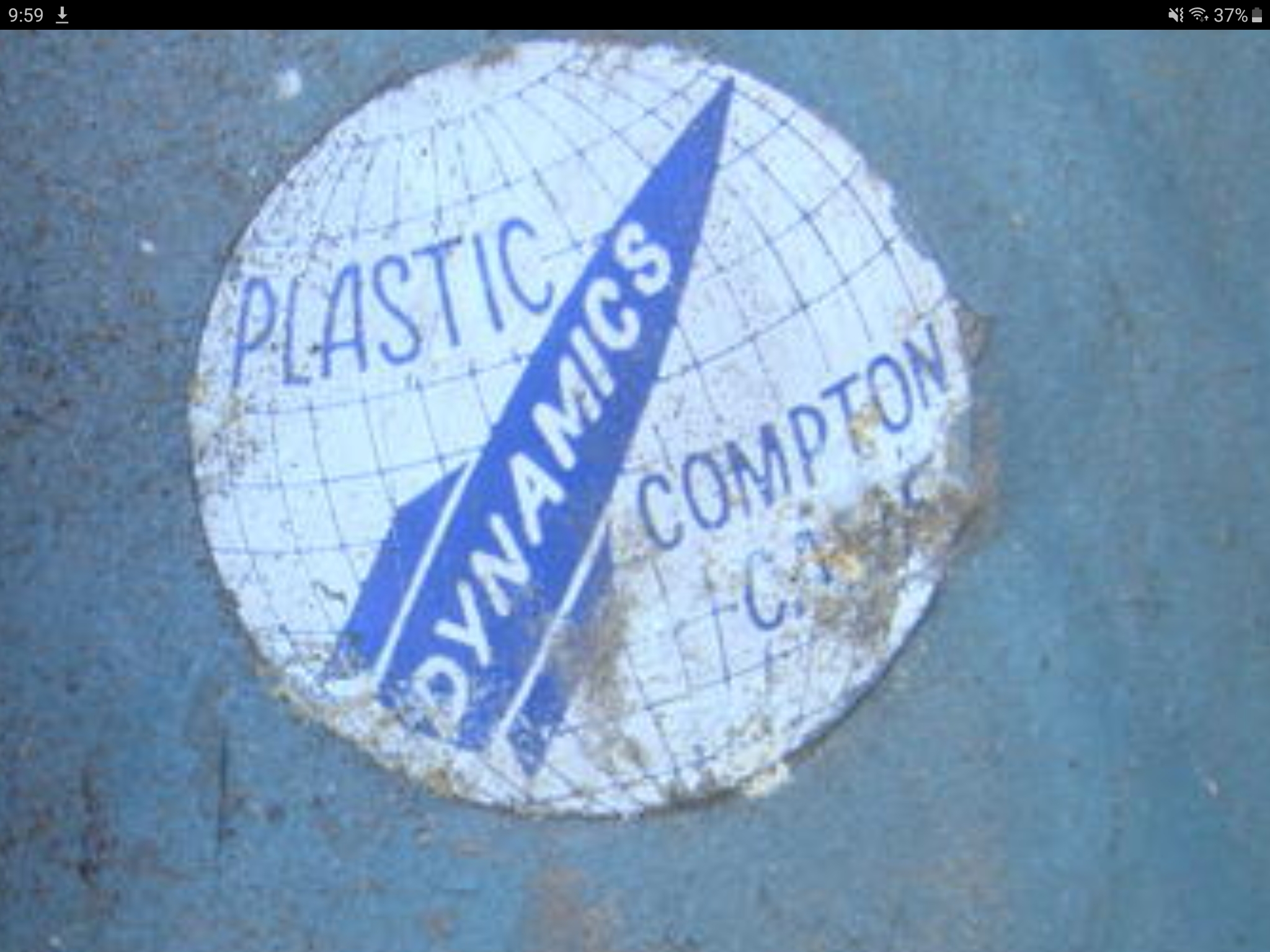

Plastic Dynamics were out of Compton CA There was also a hardtop manufactured with the trade name Plasticon out of El Monte CA. Not sure if this was the same company who moved.
Here is a thread on this:
Here is one that is/was for sale - with photos

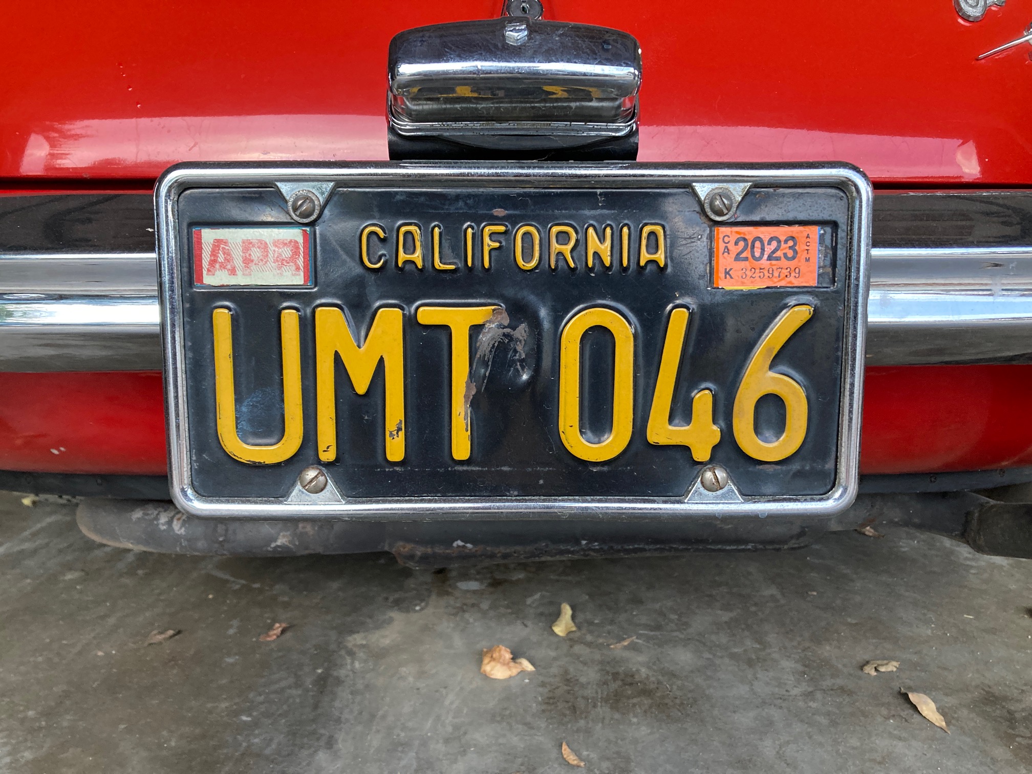

IIRC, prior to about 1970, all California plates did not have a month sticker. Everyone in California had to renew their car licenses in February and you had to go to the DMV. There was no mail in renewal. Talk about a jumble at the DMV! I think you were issued a new metal tag with the current year that you attached to the upper right corner of the plate. California switched from the yellow plates to the black plates in 1962 or 1963.
My BJ8 was built and 'despatched' Nov. 1966 according to BMIHT, but as far as the DMV is concerned it's a 1967 model year. I think they're its original plates as they're consistent with the letters and numerals of other plates that I've seen from that era (and have appropriate wear). It has the month and year embosses and stickers.

Bob you are correct about the stickers. I don't know what I was thinking. My car has a black plate like yours and it has the month stickers. Plates prior to the change to black plates in 1962 or 1963 did not have stickers and all expired in Feb each year.

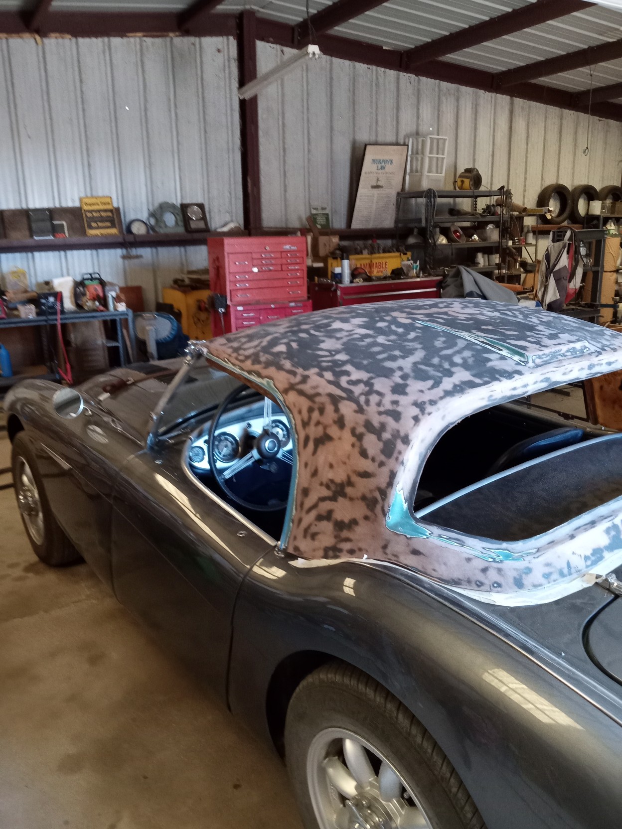

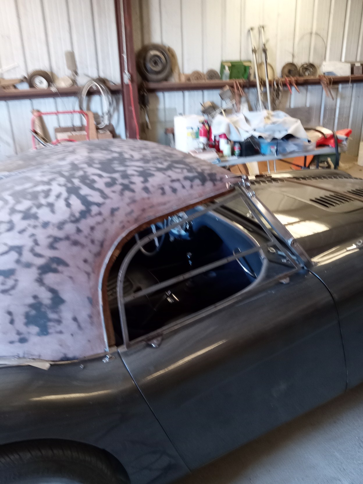

Here is the almost finished top. I know the paint isn't a match, but it's the same I used on my hand louvered bonnet so at least they match. There are still a few tweaks because I haven't finalized the rear mounting. I was most concerned that since this was not made for a BN2 as far as I know, that there would be shape or fit issues but I'm pleased with the general look and the fit......just don't get too close.

Great job Roscoe - it was common practice to two tone hardtops so that looks period authentic. That gunmetal grey is a rare colour on a 100 - only around fifty were painted that colour from the factory.

The top had to have been made for a 100 as otherwise I would not fit due to the extra length of later cars, some or all of which was between what passes for A and B pillars. It looks like a lot of 100 tops I have seen with the vent molded into the roof.
Nice work.
