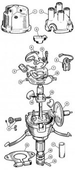

New question for the midget gurus here: The dizzy does NOT look like it is held in securely.
I'll post a pic in a few days.
The plate that bolts to the block has 2 bolts. No problem there. Dizzy is held tightly by a bolt with a square head and 1/4 X 28 nut. That plate does NOT hold the dizzy into the block. I can't seem to get the diz in far enough that the clamping action of that plate holds it securely, so the diz can be pulled right out of the block if the square headed bolt is even a little loose. That CAN'T be the way it was designed! Anybody? THANKS.

IIRC there is a "slot" that the dizzy goes down into - so, it may not be properly alligned to go all the way down quite yet. Also note that the dizzy goes in two ways - correct and 180 deg out.

Kurt, the clamp appears to be very intact and unbent. I just can't imagine that with no 'downward positive force', that the diz would not wiggle loose....right in heavy traffic. It doesn't hold it in, it just clamps the sides of the diz base.
John, I know the slot you describe and the diz is well and truly 'seated'. It's the clamp itself I'm concerned about. I'm about ready to put a thin top plate on that clamp to put some 'down force' on the diz base. I'll keep looking into this and dutifully report back.

Rut
Thom,
Lets make sure you have all the parts and they are in the correct order. Number 13 clamps to the dizzy and bolts to number 73 which is bolted to the block and holds the dizzy drive in place. As said earlier the clamp can be previously over tightened and break the base of the dizzy giving a loose fit which will allow the dizzy to rotate inside the clamp and change timing. If everything is in good condition the dizzy won’t be able to rotate or come out of the block. I know this is basic stuff, but if someone used a clamp from a different application or it’s upside down you would have the issues you’re describing.
Good luck, Rut

I found that the diz clamp was a bit bent. It now clamps correctly and start's with a turn of the key. Now I need to look at the accel pump because there's a definite dead spot / hesitation when revved.
