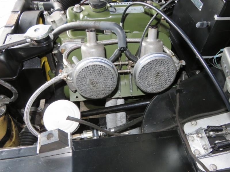

I'm new to this board and need help! This past fall I purchased a 1960 Sprite with a 1275 in it. It was recently completely rebuilt by the previous owner (might be on this board: Patrick Casey). He'd driven it less than 500 miles before I purchased it and had no oil leakage issues. What it's doing is it will "puke" oil out the front and back of the engine. The first time it was about a 2/3 of a quart overall. The second time it was maybe a cup. I expect drips but not this. I'm hoping it's something to do with the crankcase pressure as I'm a basic mechanic and not looking forward to having to do major work.

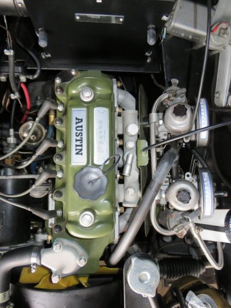

You can see in the pictures that the timing chain canister is vented to the carbs. The valve cover vent is capped. Should I be venting this differently? Oh, and the oil cap is vented. Any help and/or insight would be greatly appreciated.

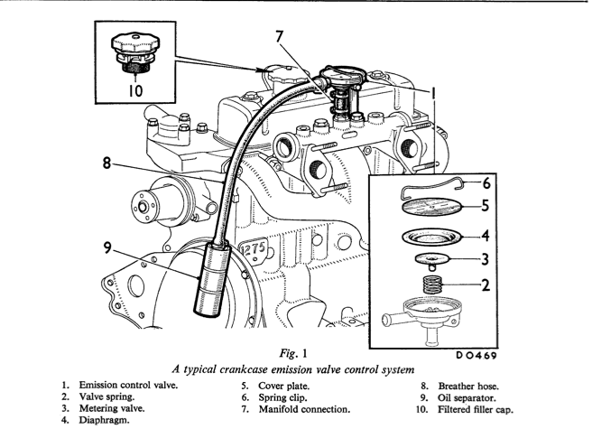

What about the 90 degree fitting in the middle of the manifold? I assume that's plugged since it wouldn't run very well otherwise (if at all), so just confirming. Sounds like you still have too much internal pressure and you'd probably be better off using a Smith's PCV off the manifold, rather than the vacuum from the carbs. I'm not sure why things wold suddenly change, but he higher compression pistons may create more pressure than can be alleviated by the draw from the carbs.

The 90 degree fitting is plugged. If I try what you mention, what do I do to the openings on the carbs...plug them? The Smith's PCV valve, do I buy that from Moss? Sorry...new to all of this.
Either find a good used one or the one from Moss. Use a short piece of hose to bridge the two ports on the carbs. I can't guarantee it will be a cure, but it's the first thing I would try. Have you had any feedback from Patrick?
Something to check: Remove the oil filler cap with the engine running and place the palm of your hand over the opening. Is the air rushing out or is there a vacuum?

Thinking out loud here ... new engine ... could be something leaking around a gasket (timing cover or oil pan). Or maybe the front seal was not centered with the timing cover was installed.
Just checked and when I remove the oil filler cap and put my hand over the opening there is a vacuum.
Ok ... start checking for loose oil pan bolts and timing cover bolts.
Question...with the oil filler opening pulling a vacuum does that mean that it's not a crankcase pressure issue?
If it is pulling vacuum at the filler, then crankcase pressure is probably not your problem. UNLESS there is significant ring blow-by at higher rpms.
I just checked for loose bolts. None were loose but needed a bit of tightening. I just snugged them up. Hard as **** to get to the timing chain bolts. I've never had it "puke" while on the lift. It's always happened while out driving, but in the tightening I just did, it showed zero seepage when started and warmed up. I'll try and get out in it this week if it's dry enough. Trevor, I'm in Floyds Knobs, so I have the same weather you do. Thanks for the input. I'll report back once I get a chance to drive it and see how she does. I'm also open to further input.
