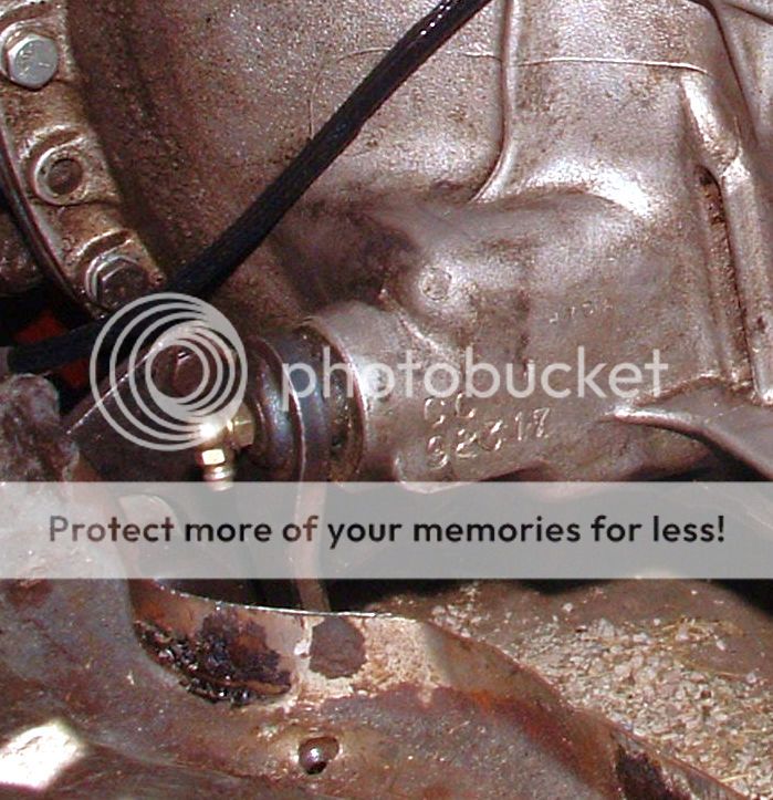

The 61985 would indicate that the overdrive is from a 71-72 TR6. Should be a number stamped on the case near the clutch lever that identifies the main gearbox (which may or may not match the OD, I have a TR4 OD on the back of my TR6 gearbox).

Gearboxserialnumber_zpsb8268f06.jpg~original

Chuck, that 306812 number is a casting number. The transmission serial number should start with a "CC" or "CD" and be stamped either on the clutch cross shaft boss as shown in TR3driver's post or if it is out of a later TR6 it may be on the bulge for the starter on the other side of the transmission case.
