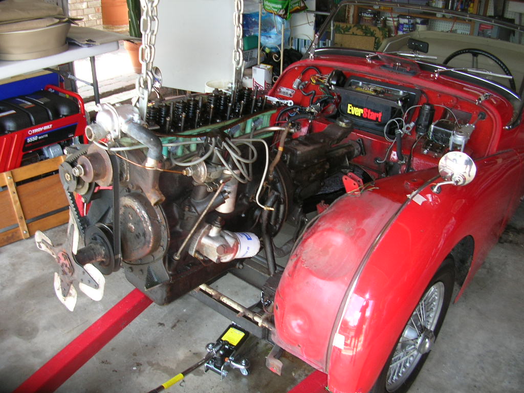

We got the motor and trans out as one unit and used a adjustable lift... 15 minutes after we had everything disconnected... I attached a picture, hope I di it right! The work starts now as I get the engine bay ready for the new engine and Toyota trans...
I am very much in need of a TR3 shift lever. The one we pulled out was broken and brased together very crudly.. If you have a spare one please let me know and I'll more than happy to pay... PeterK , I sent you a PM about the Toyota conversion....You got to lov these LBC's
