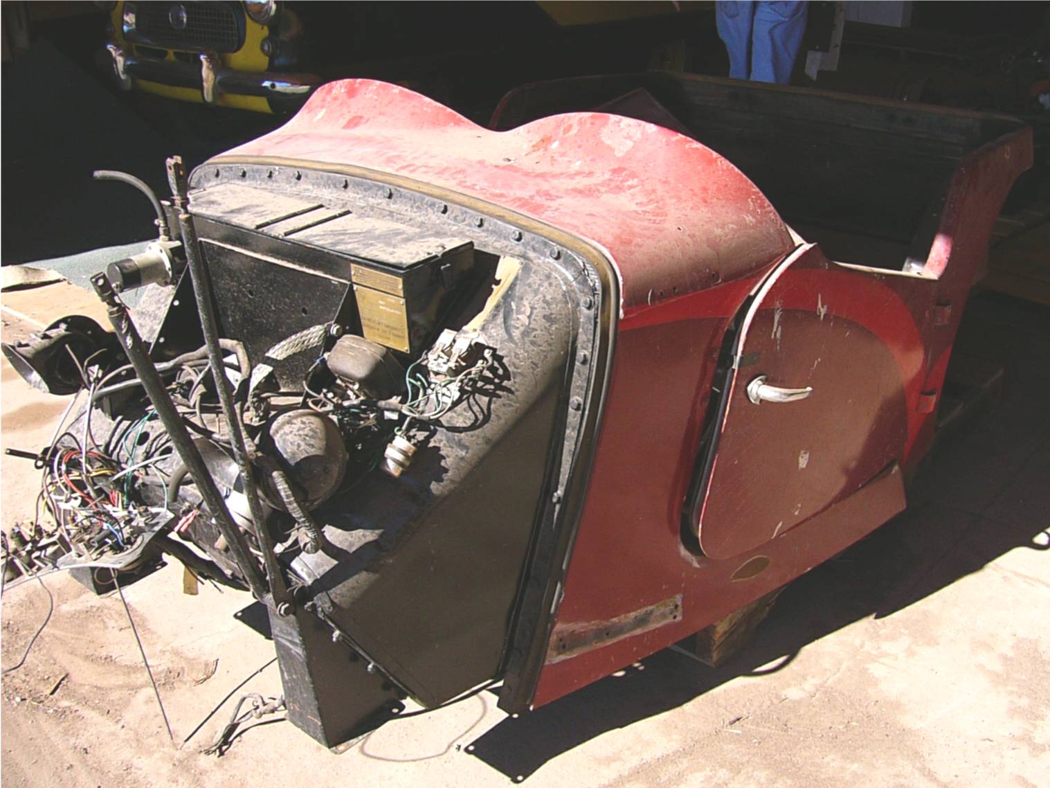

I bought a MGTD that is missing a lot of parts and the engine has has water in it for 7 years. I bought a 72 MGB-GT that has the lower body rusted out, donor car. I'm puting the 72 drive train in the TD and the Disk breaks on the front. Does this make me bad person? :I would like to show pictures of the condition when i bought it but don't know how to attach them.

Thank you for your comments, I now have the 72 rear end installed in the TD and the springs line up. I had to weld a spring adaptor plate to each side 3/8" wider on each side, turned out great. I'm working on the disk breaks, I ordered new king pins and it looks like a streight bolt up except for the tie rods are a little long approx.1/2" on each side.
BarryE. I could attach pictures if I knue how. /ubbthreads/images/graemlins/jester.gif

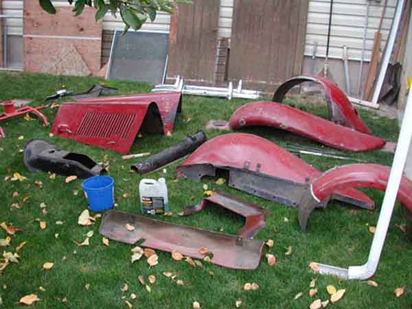

I'm sorry but I can't figure out where this motorcycle stuff came from. Where is the picture that you are refering to?
BarryE. /ubbthreads/images/graemlins/rolleyes.gif
