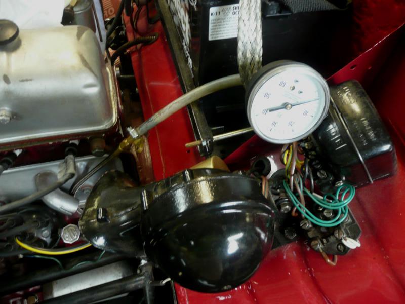

If you which to check your gauge, its a simple matter to insert an external gauge.
Attached is a lashed up gauge I used at start up. At that time I had no dash in the car.
With a dash you just break at the flexible line and attach using tubing and hose.

thanks for the replies....esp. PJ...I thought those pressures were too high....I've never seen a non competition engine with pressures like this. I'll "T" another gauge in to confirm, but I seriously think that the bypass stuck during the car's inactivity.
