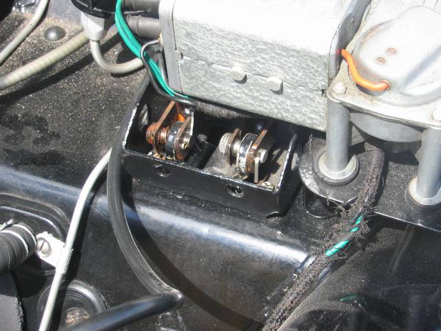

Don Elliott
The wiper motor on my 1958 TR3A (TS 27489 LO) has the parking feature. See attachment.

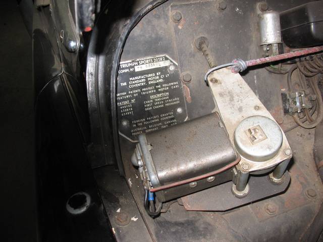

Don Elliott
Attached is a photo of a wiper motor on a short door TR2 (TS 6000 LO) or close to it. It is the original motor on the car still owned and driven by the original owner. Someone in the past has grounded the self-parking wire incorrectly, but you can see the spot where it used to be connected.
