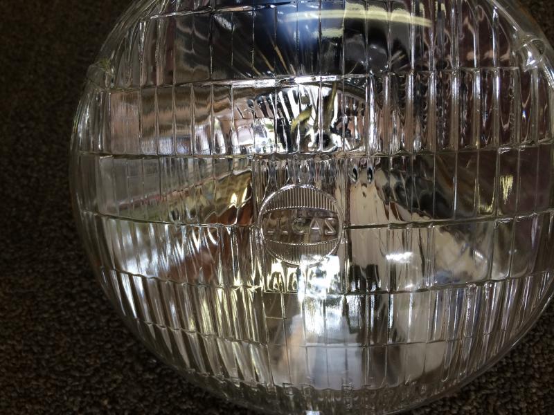

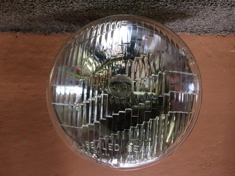

A few years ago I purchased 2 used Lucas Headlights to use on my BT7. Although I know there are better, brighter and safer alternatives than the original bulbs, I just like the look of the Lucas logo up front. One of the bulbs I purchased was a match to an original in pattern and marking. The horizontal lens lines were straight across the surface and the lens had a large "2" at the top. The other bulb was different. The lens lines "stepped up" across the face of the bulb and instead of a "2" at the top, it had an arrow pointing right. There were some other numbers on the front. JC 10170 S13 and 73. Anyone know if this might have been an English or European version? I just purchased another 'standard' Lucas bulb to give me two matching bulbs, but was just wondering if anyone has any ideas. This is certainly digging deep in the weeds when it comes to important issues of our time......
The bulb on the left is the 'standard' and the one one the right has the "stepped" pattern.

Rob, I really don't know anything for sure but I also have an unusual specification in my headlight bulbs. I have had the these same headlights on the car for over 20 years and they were on the car when I bought it. The owner I bought the car from said that he had driven the car in Europe. The low beam of my bulbs angles to the left instead of to the right as most American bulbs.
I wonder if the arrow on your one bulb means that is the direction of the beam when on its low beam. If the arrow is pointing right that would mean it is pointing towards the curb when driven in a country that drives on the right side of the road. Just my guess.

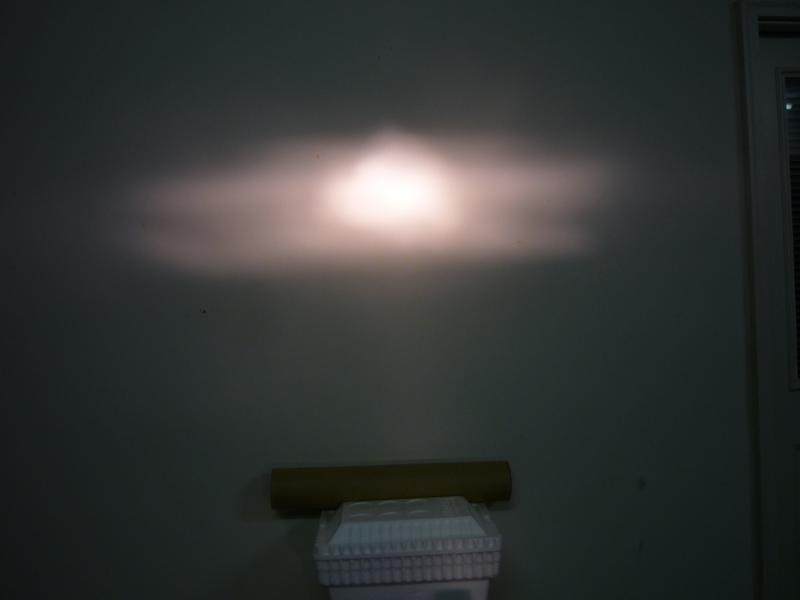

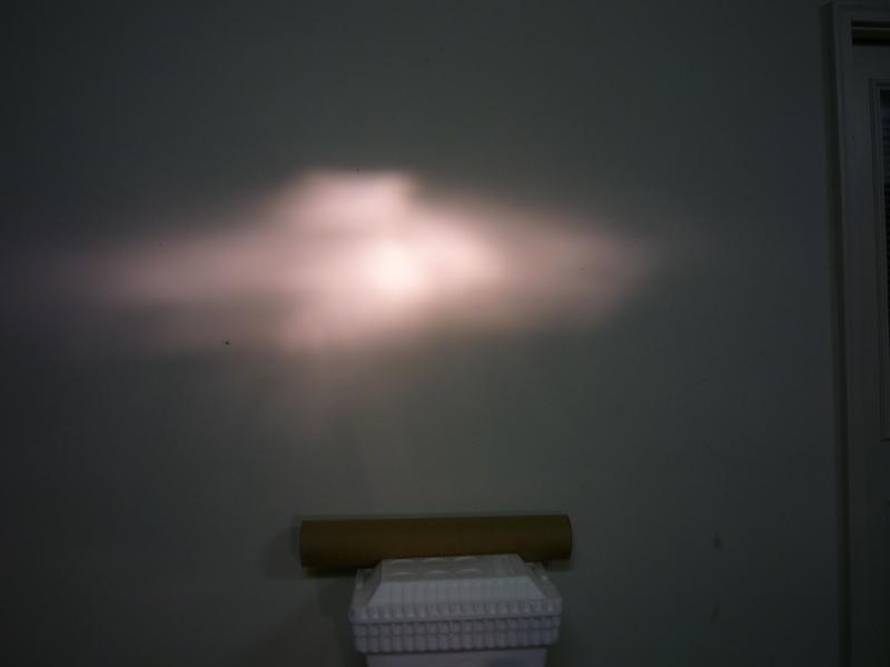

Rob,
I can appreciate the 'cool factor' of the Lucas center logo. The diagonal pattern is for right hand drive areas and therefore 'dips' appropriately. I ended up with several NOS of these and checked out what they would actually do when switching from main to low beam. My crude garage-wall test showed they would aim the low-beam into the oncoming lane if used in left-hand traffic. Incandescent bulbs are pretty dim by today's headlight standards, so I doubt if anyone would even notice they were 'dipping' at them.
I ended up selling them to someone in Australia, where they could be used as intended. Maybe someone with a RHD car would want them for that final concours touch.
