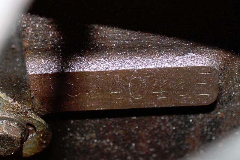

One other thing to look at would be the body number plates, especially the "EB" plate. It won't match the commission number but it shouldn't be vastly far away from the commission number. Same, too, with the engine number (assuming the engine is original).

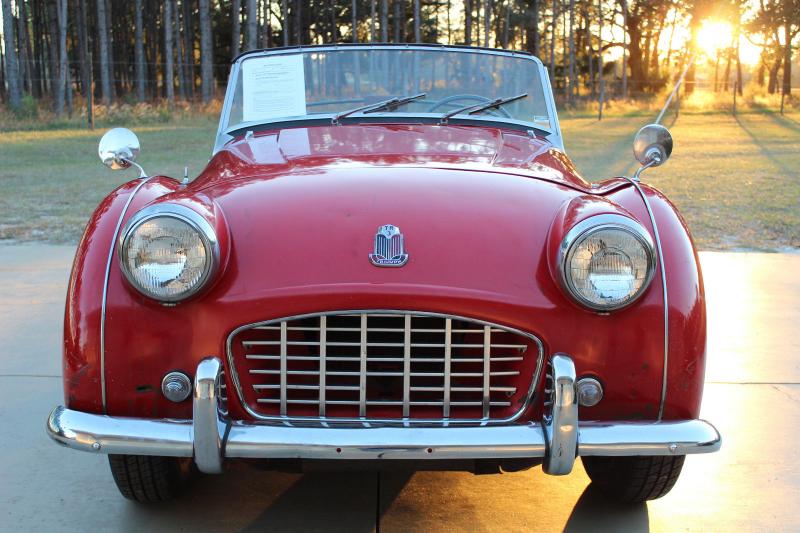

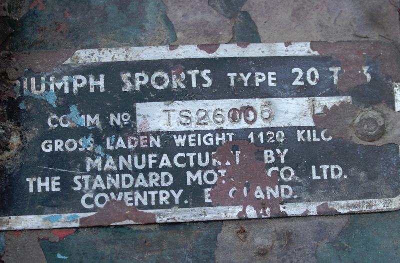

I am including images of the data plate showing the commission number. I think the L is there, it's just way off to the right. I also an image of the engine sn and a shot of the front of the car. Thank you all for your time.

Geo Hahn
You are right, the L is there. The rivets also look correct (original). Mine:

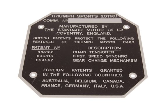

Data plate is the style for the TR3A (smaller; the TR2's and 3's had larger, square plates like this one: 458750-Large.jpg ). And since you have door and boot lid handles, it's likely someone replaced the apron at some point.

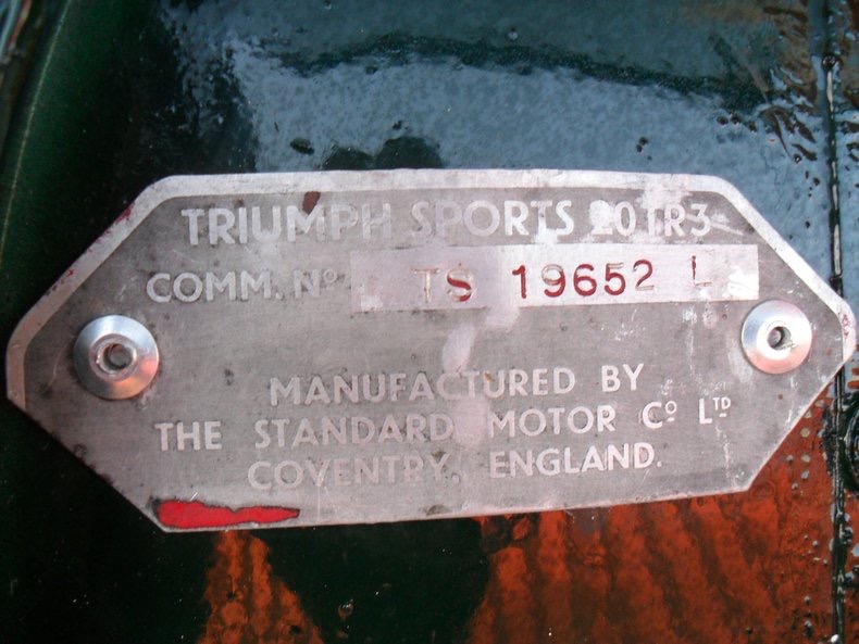

The commission plates changed from the large octagonal ones to the rectangular plates in 1957. There was an interim style of plate that year, commission numbers TS19XXX, where they took the large one and trimmed off the bottom (see attached photo). My 1957 TR3, TS20447L (built July 1957), has a rectangular plate. Speculation by the Triumph Register folks in the UK is that the trimming occurred because the patents listed on the large plates were no longer valid, so they eliminated that portion until rectangular commission plates were introduced. No other plausible explanation has come up.

According to that Piggott book tr3A did not happen until TS22014.
Yep, that takes Mastaphixa’s car out of any possible transition range. The apron was changed by someone who liked the small mouth more. The good news, if you want to go back to the “original” widemouth, your small mouth apron will bring more money than the widemouth will cost!?!
Also, the far right L is typical, as I don’t think they knew which drive the bodies would have until after the plate was attached. The L was added later.
