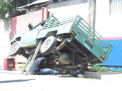

Jackstands? You guys actually paid for and use good quality jackstands? Check out this picture for a better alternative.

That's a Darwin moment waiting to happen. Geesh. Ingenuity is to be commended, but that might be pushing it a bit too far!
