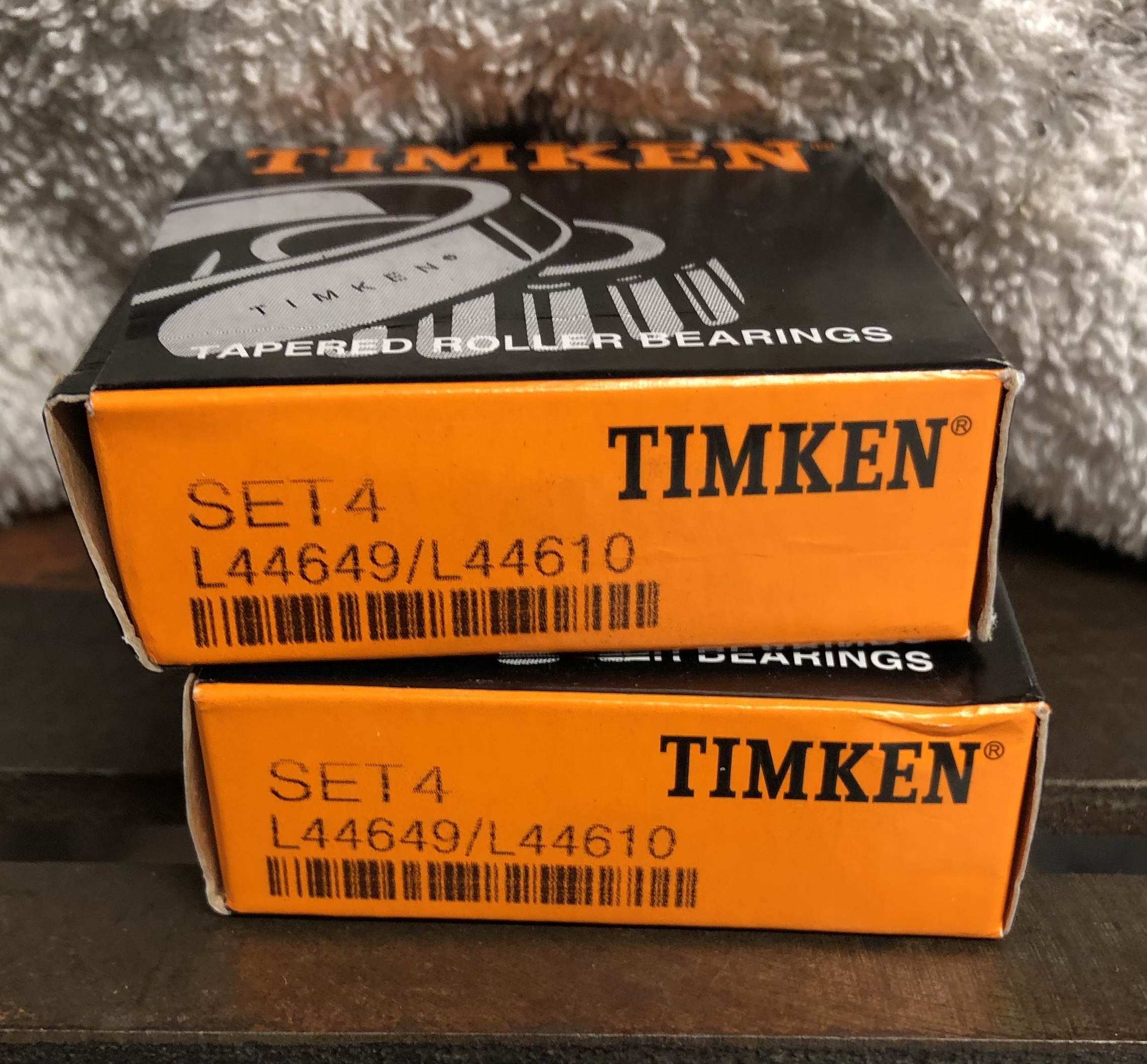

Rocky_LC
Here is the P/N for the GT6 front inner axle bearing and raceā€¦.
TIMKEN Set 4 L44649/L44610
