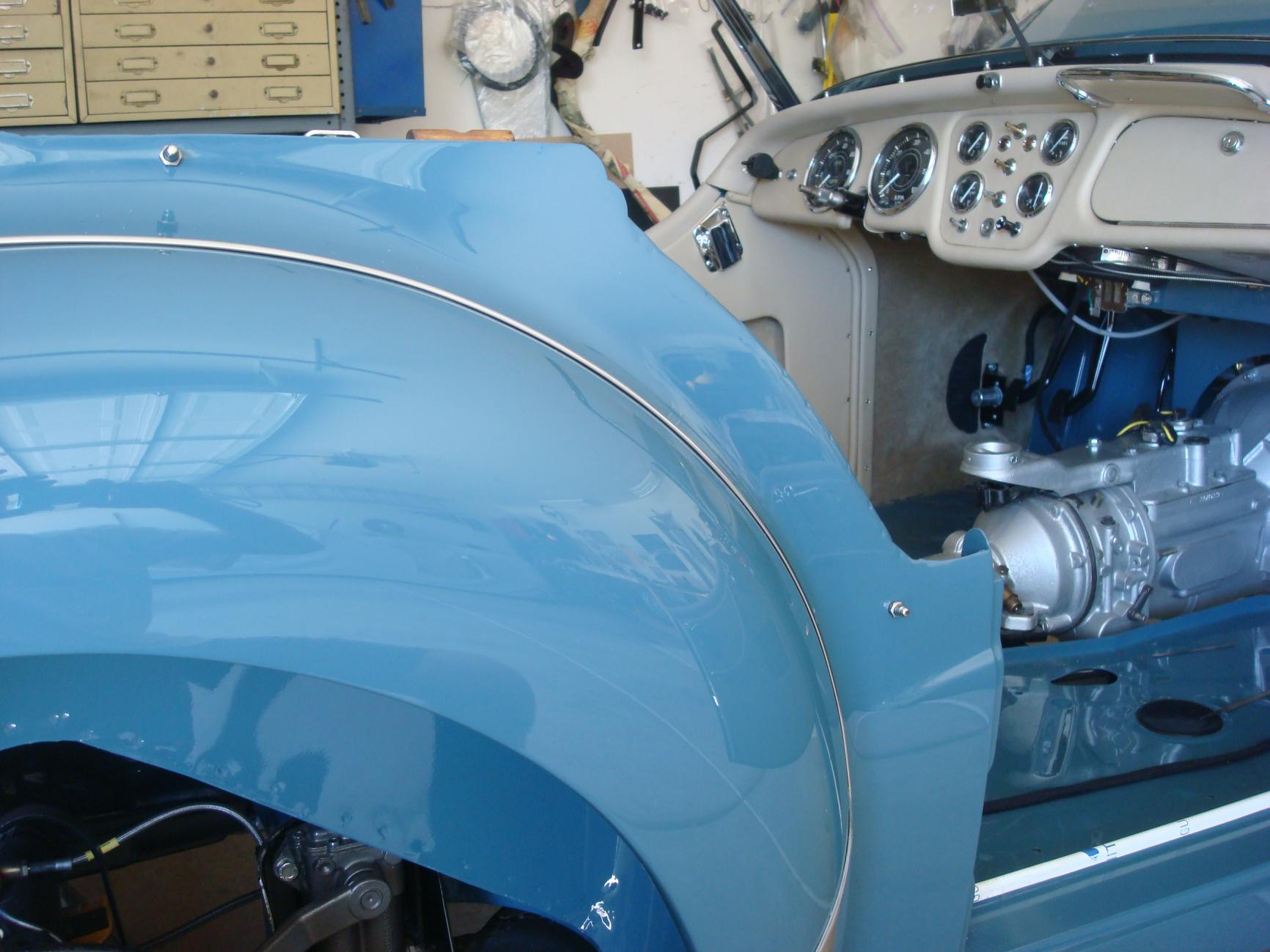

The small stuff can be the most time consuming and frustrating when doing a restoration. I just discovered this while installing the lift the dot studs to the back of the car. My car is a 1956 that was delivered with a hard top, no convertible top. I believe there should be one more stud on the side for the hood stick cover. I've also seen pictures that show two studs in that area. After looking I can see no indication that a hole was ever drilled in the body for the stud. I don't have an original convertible top or hood stick cover to see if it should be there. I do have a tonneau cover for the car and it does not have a fastener for the missing stud. Now I have to get a hood stick cover to find out where to drill the hole.

Of course when you get a hood stick cover you have to install the female LTDs on it -- so having it in hand isn't going to tell you where the stud should be.
Be aware (perhaps you are) that the location of that stud changed along the way. At some point they went with a tonneau that had a slash in it to help it tuck behind the seats with straining the zipper and other fittings. I mention this as looking at a later car (like mine) would be misleading.
BTW -- Did you use any washers under the LTD studs? Some (well, me anyway) use a plastic washer under those to protect the paint work. I got some at Ace but IIRC some of the vendors offer them too.

Hi George. I think TRF has a good explanation of the tops in one of their catalogs, I'll have to find it. I make my own washers out of old blister pack. I got some cheap hole punches from HF and use them to make a punch out the size of the stud, then punch a smaller hole in the middle.

One tip on those LTD threaded posts - use a washer and a nylock nut. They can be a real pain to get at if they become loose.

In addition to the hood stick cover, the missing peg is also for the soft top snap nearest to the side curtain. Same peg is also used for the early tonneau (without the tuck at the dogleg). Beware buying a pre-fitted soft top or tonneau as each item was individually fitted to its matching car by the factory. Peg spacings can and do vary.
Two extra pegs for the hood stick cover go inside the cabin towards the rear of each of the two short cockpit cappings. Sometimes the holes are there in the cappings beneath the vynil covering.
If the hood stick cover fits the existing pegs, then the foremost peg could be reasonably plotted from the cover snap. Otherwise a template might be needed from a similar TS number car. I find drilling through masking tape can avoid chipping new duco.

I looked at 2 cars yesterday I found the measurements to be off by 1/2". One car had 2 holes in the area that mine has none. I'm going to wait until I get a convertible top for the car and fit it that way. Thanks all for the replies.
