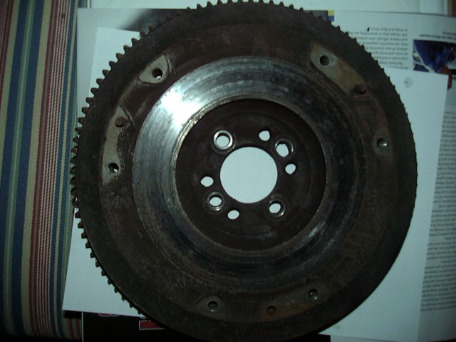

Well it looks like the flywheel I have is a 1275 redrilled to go on a 948. Pic attached. If I should put it in the scrap metal pile just let me know. It was on a 948 but I do not know how or if it actually worked ok. $10 plus shipping and you can have it. Bob

Thanks for the offer, but I think I'll hold off until I decide what to do.
Thanks all for the info. There is a shop that specializes in A-series engines not far from here, and does all kinds of machine work, so getting the 948 flywheel redrilled is probably not difficult. Might lighten it a bit at the same time. I suspect that this might be a viable way to go.
