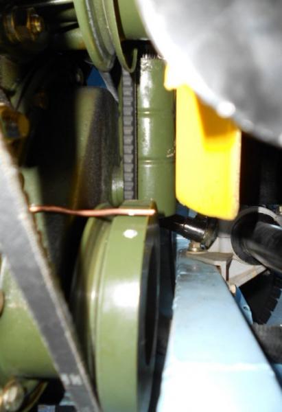

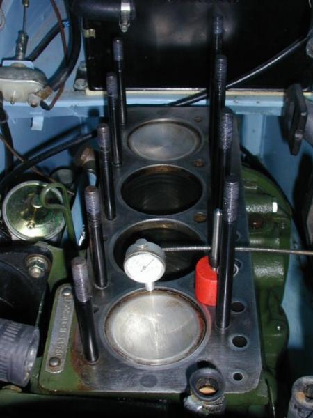

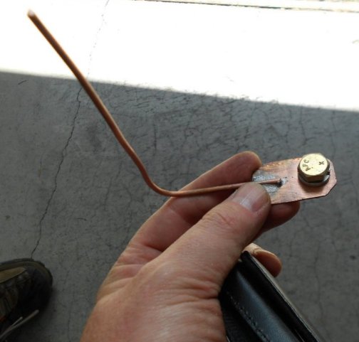

I didn't have them on my 1275 either... but I added them. The trick, of course, is to get a true bead on Top-Dead-Center of cylinder #1. Thankfully, I had the head off and had a really good gauge; there are other methods too though. Then, added a wire pointer and painted on TDC on the harmonic balancer (added 10 degrees too).
BTW, when using the dial gauge to determine TDC, the gauge should be set up at the center of the piston, not the edge. This is to avoid any error should the piston rock back and forth at all on the wrist pin.

Thanks Gerard. Good point. We used the multiple marking method then splitting the difference... which, I think, allows for a pretty accurate determination (even with some lateral piston movement).
