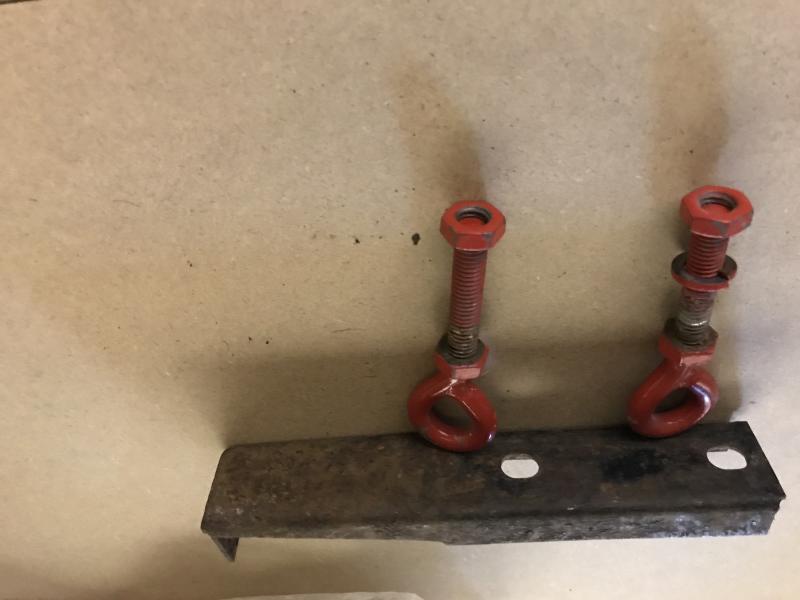

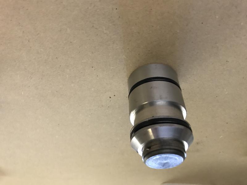

I received some parts with my Tricarb. I have identified most of them, but not those on the attached pictures. If ayone knows what they are I would be greatful to be enlightened.
I don't think either of those--esp. the eye bolts--go on a Healey (at least, there aren't any of these on my BN2 and BJ8). The second one could be a brake cylinder piston, but not for a Healey.

The second picture looks like an overdrive accumulator piston with an 'O' ring conversion - AH Spares part OVD202A
The eye bolts in the first pic, I think are part of the seat belt anchorage ( I have them in a box of bits from my tricarb, yet to be fitted, but can't see them in the parts list so far!!!)
I think we have a winner, though it's curious that it wasn't installed since the O-ring is supposed to be superior to the metal-ringed type (at least according to AHS). The DWR uprated accumulator still uses the steel rings. The activating pistons went from steel rings to O-rings in later cars.
I believe that it was replaced for some reason (hopefully with another upgraded piston) when the OD was rebuilt. The one I received has been in a car, it can be seen on the top of the piston (not visible in pic though).
Any ideas on the bracket in the same picture as the eye bolts?
