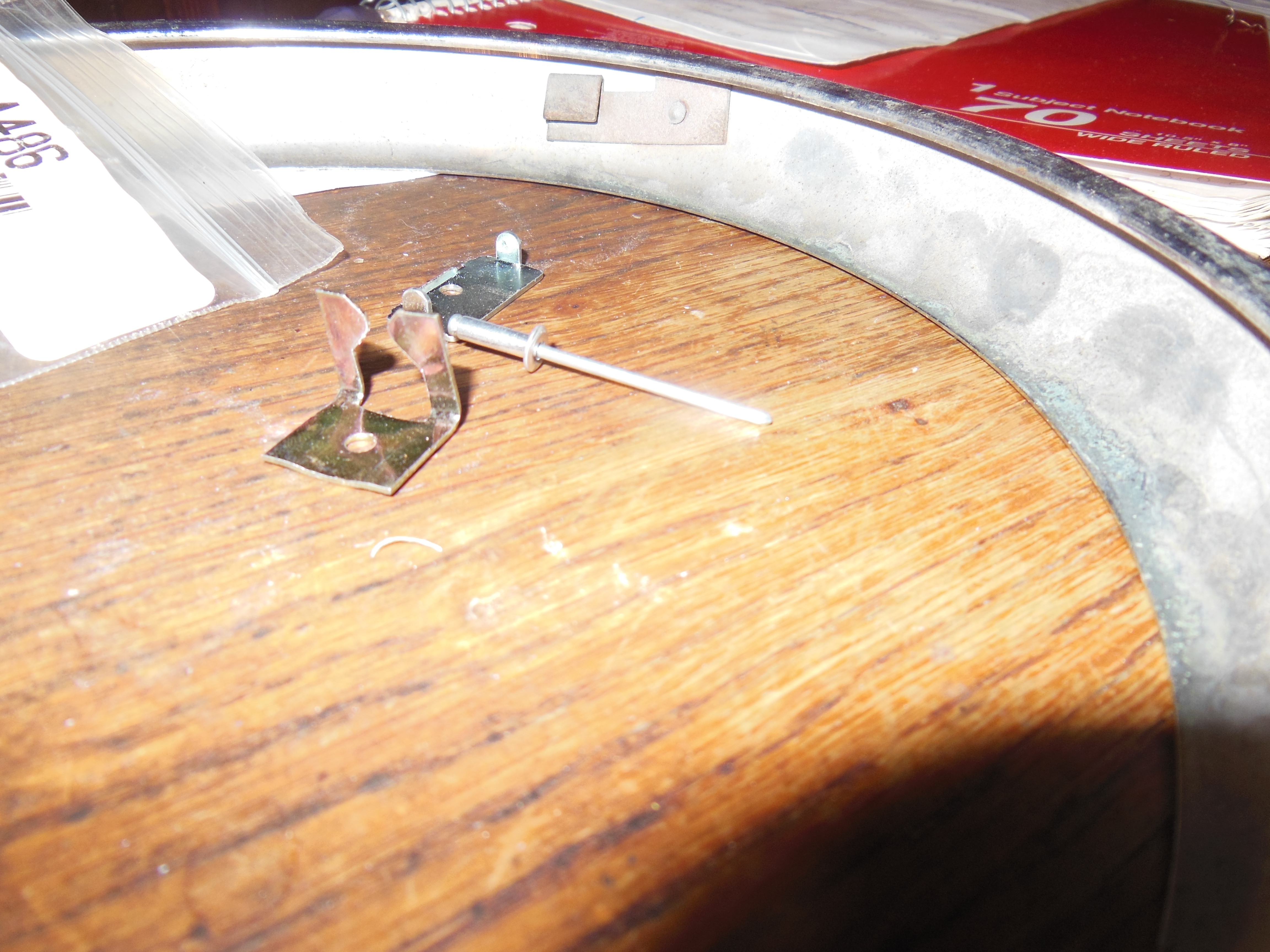

Has anybody replaced the headlight bucket clip that the trim ring clips into. They are available from Moss. I am cleaning up mine and the clips are rusty and may be weak. If the quality is ok it would be easier than making them fro scratch. Frank
sp53
Hi Frank I have one somewhere, but I got it years ago. It came with a small pop rivet and both small pieces for the connection. It looked like it would work fine plus the size is small it would be difficult to fabricate. I do not think I used it because I found a different set up or something. I will look around for it.

Hi Frank here is a pic of the one I was going to use when the time comes. Not sure exactly how it fits and if on pieces goes on the bucket or not. There a couple of variants on the rings and the buckets.
Steve
