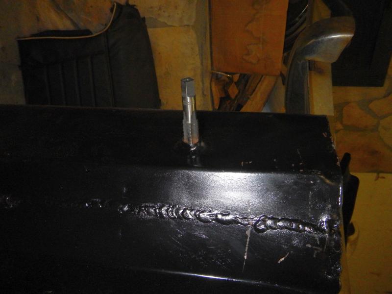

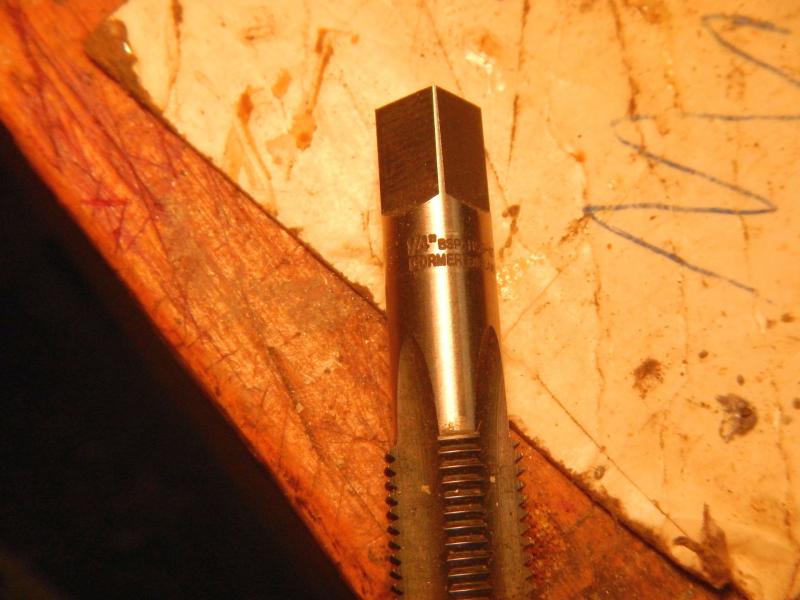

I have replaced my original tank with a replacement steel tank last year, but it leaks where the old metal fuel line attaches to the bottom side of the tank (corroded a bit) Anyone know the specs on the threads? I need to get a new attachment and it seems that part is not sold by Moss or Victoria (where I got the tank).
Thanks in advance!!
David
It is a 1/4 BSP thread. British Standard Pipe.
David
