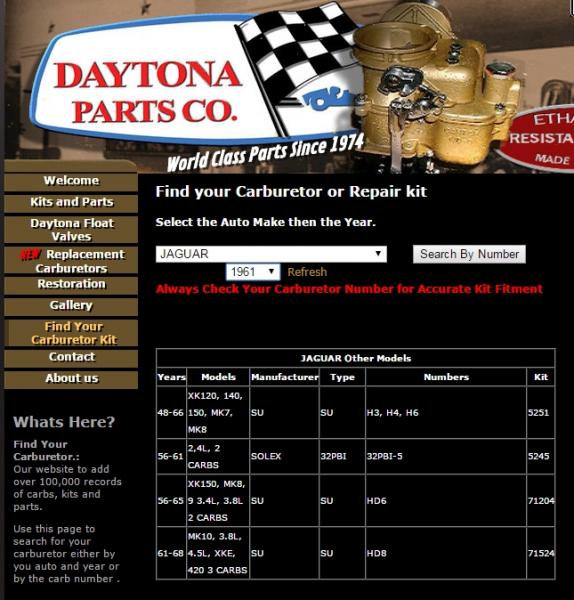

Received from Daytona,
John! Sorry, but at this time we do not make any of our Daytona Float Valves for SU applications. These are in the works, but it may be a few months before they are in production. Please check back with us at a later time.
Thank You!
RON
DAYTONA PARTS COMPANY
Thank You!
RON
I wrote them a couple years ago and got the same reply.
I just called them and don't hold your breath. He did say if someone is nearby, they may be willing to see if one of their existing valves could be made to work.

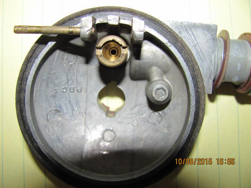

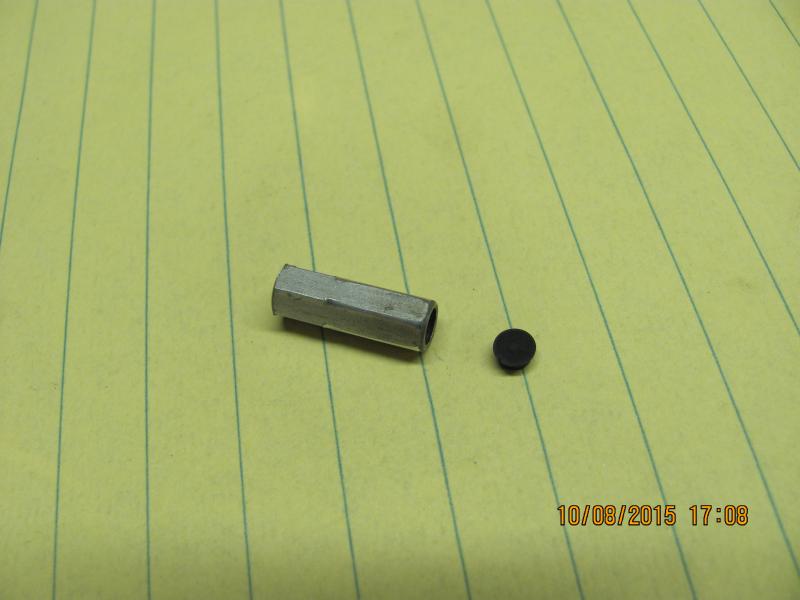

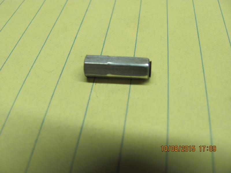

I missed this thread originally but saw it today. What a revelation - I have what I now believe are a pair of the Daytona valves. They were in a pair of HD6 carbs on a Healey I bought in 1987. I had never seen anything like them and never knew where they came from/who made them. I used those same valves for 20 years and never had a single issue - I love them. A few years ago I changed to a triple HD6 set up and had to go with the viton tapered since I needed three and only have the pair.
The pair I have may have been made by someone else (no markings on them), but they are exactly as the website shows. One advantage not mentioned is that the small rubber 'puck' is just a snug fit in the aluminum 'needle'. After several years in the carbs I noticed a small depression ring had formed in the 'puck' where it seats against the flare in the valve body - I just flipped the pucks over and had a fresh flat surface to seat against. When I next had them apart a few years later, I found the previously grooved side had flattened out, so I flipped them again.
I bet I have shown/talked about mine to at least 50 people over the years at the races and no one had any guesses where they came from. Based on my experience, these are the best valves I have ever had and if they are available, I will be getting some more.
Thank you for enlightening me. This place is truly a great source of info.
Dave
In case no one noticed, I am quite excited at solving a 25 year mystery.... So I went out and pulled a float top off and took some pictures, You can clearly see by the wear on the aluminum hex that they have been in service a while.

Those are carb rebuild kits, not Daytona Float Valves. Unfortunately.
red57,
That's very interesting. Perhaps email them and include those pictures. Maybe they will recognize them as theirs or modified versions.
Personally, I'm not opposed to buying a set and modifying them if necessary.
Additionally, when I talked to the guy, he didn't seem to think there was a market for "that import stuff". I tried to convince him otherwise, but he said there are other projects in the pipe ahead of these. Maybe if enough of us call/email them, these could get made.
I have never seen a jet like red57 pictured it must be a very early version if it is a Grose???

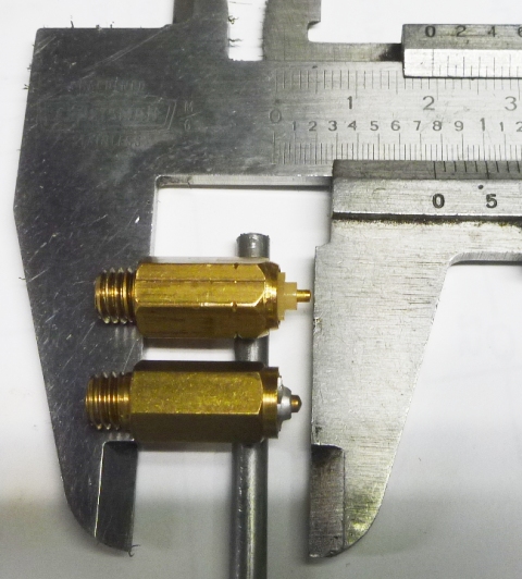

Moss sells the same Grose jet PN for all carbs BN1 - BJ8 - therefore the HD8 jet dimensions are good for all:
Threads - 1/4-28 x 3/16" deep. Total height of jet not counting threaded portion - 3/4". Jet metering hole - 3/32" D.
attachment.php
