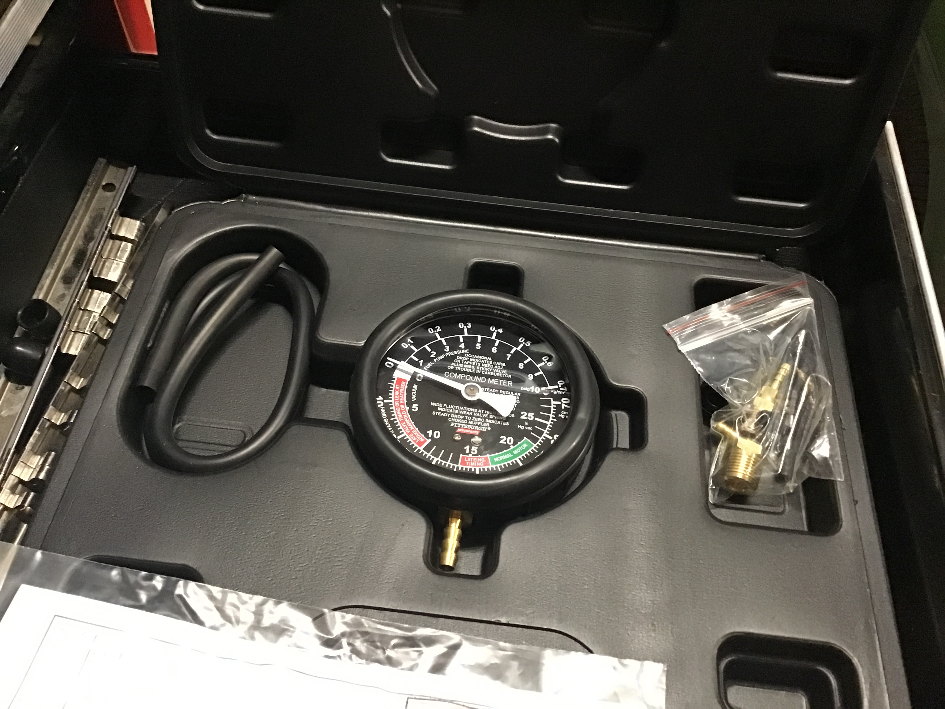

Just curious, how are you guys checking fuel pressure?
I used a fuel pressure tester tool. Super easy to use. Connect the vacuum line from the tool to the output side of the fuel pump and crank the engine for a few seconds.
