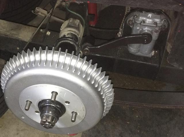

I purchased finned aluminum drums for my TR4 from TRF some years back (P/N: HP 34), but they don’t seem to carry them anymore.
They are Brembo manufactured Datsun 240Z drums. TRF had them modified prior to sale since they fitted perfectly right out of the box.
