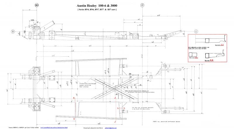

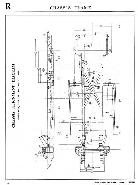

jstmorris
R2 Chassis BN4-BJ7.jpgCHASSIS DESIGN-AMENDED Ba.jpg Good Day; Here are two diagrams of the frame that was used for the 6 cyl Healey up to MkIII BJ8 Phase 1. the first is from the workshop manual and the second is based on an original factory blueprint. Hope this helps.
--Scott
PS: The second diagram can also be found mid-page at the AHC of Southern Ontario website
https://www.ahcso.com/detail.aspx?menu=59&app=299&cat1=764&tp=2&lk=no&title=Technical+Articles
