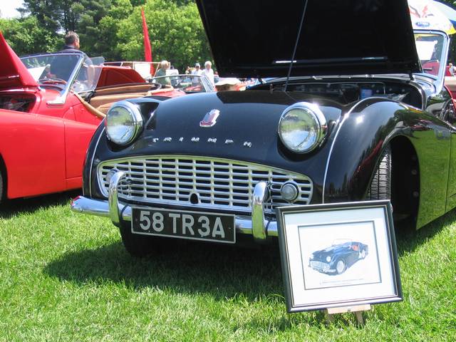

About 8 years ago, I got a quote from a local plater who wanted $1000.00 to re-do the front bumper on my TR3A because I had some scratches from 50,000 miles of driving since it was re-chromed in 1990. I said forget it. Here is what it still look like after 97,000 miles.
