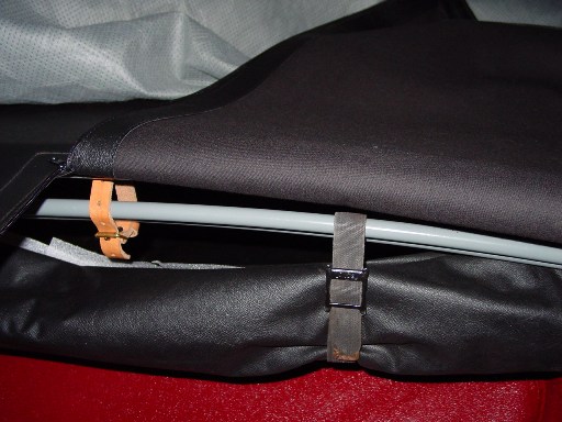

this is my understanding of what it looks like. One leather strap to hold the bows to the rear deck, and two fabric straps to hold the hood to the bows. Hank Leach made up a few of the leather straps, but the hood straps have not been produced by anyone recently. MacGregor does not have any of the straps as of late last year.

I am confused. Are there three straps then, with one leather and two fabric straps? I appreciate the picture. Jack, I don't suppose you have a picture of the original cloth straps as well as the measurements? And how does the leather strap hold it to the rear deck?

Kevin, it was my picture.
Yes, it is my understanding, although could be wrong, but my research says that there was a leather strap for the bows and two cloth straps to secure the hood to the bows. The metal rib located behind the edge of the deck has a slotted hole in it for the leather strap to pass through.

Sorry for not giving you credit for your pic, Scott. It was late and I was wiped out when I made my last post. Thanks for the pic. The only slot I found can't be more than a sixteenth inch thick. I don't see how I am going to get the leather strap through. Am I looking at the correct area?
