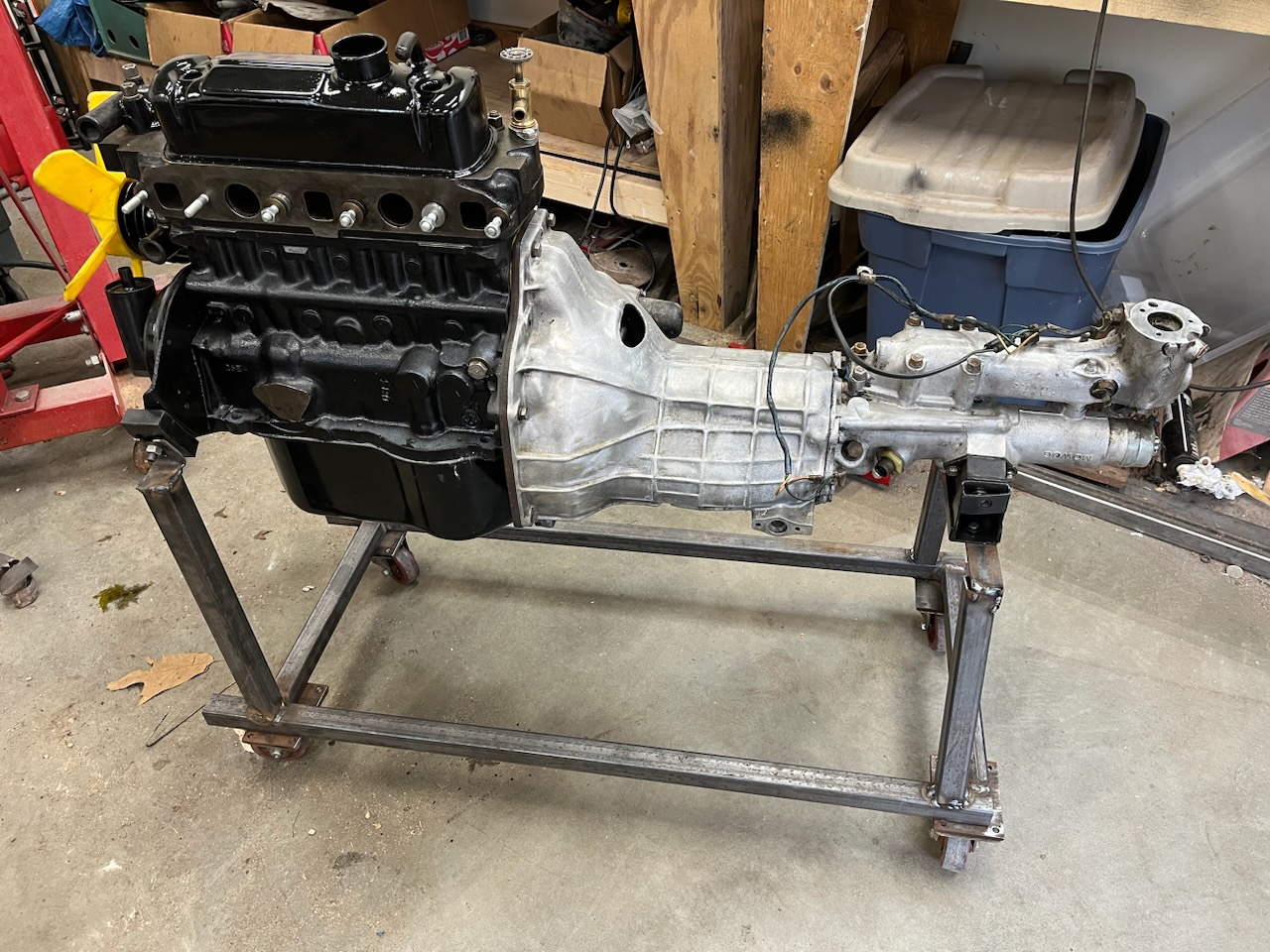

Got it all together and mounted on a stand. Makes moving it around easier. I hope to set it up so I can start and run the engine before I install it in the car.

Did you have the big ends resized with the ARP bolts in place?
D
DavidApp
I must admit that I did not get the big ends resized after I installed the ARP bolts. I did see a You tube video that showed a very slight change in big end diameter when the ARP bolts were torqued down.
I used the stretch method of torqueing and had to go up 5 ft/lb to get the required stretch.
David
