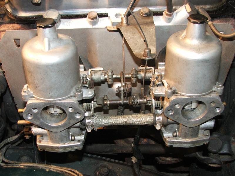

Hey everyone,
My car's a 1974 MGB with an 18GK series engine. I wish I knew the story behind that, but I don't. At some point, the original HIF SU carbs were removed and a set of HS's were fitted in their place. Those carbs have always seemed a bit dodgy. I've had new bushings and shafts done, replaced floats and jets, aligned needles, cleaned, attempted to tune etc, and it's like they're never quite spot-on. I've checked valve clearances and ignition timing along with that. I can get the running to be pretty good, but maybe never quite great. I wonder what role the car's mongrelization may play in this.
Someone nearby is selling a rebuilt set of HIF's along with extra parts for $225 negotiable. I'm not an absolute stickler for originality or anything like that, but aren't those the "proper" carbs for my car's engine?
Does anyone still have these fitted to their car? I'd like to think about getting them, but that's also $ that could be spent on other things too, you know?
Any advice would be appreciated.
Thank you,
-William

Just got through watching John Twist's video on matching the piston to the carb body and doing that procedure with my own car. I have mine where they fall at the rate where one reaches bottom at about one second faster than the other. That's the closest these are going to get. Went ahead and did a carb service and think I got it all squared away. Taking it on a test run shortly.
wkilleffer
wkilleffer
Another thing: When I was getting the carbs ready to do that adjust and balance thing, the front carb seemed to be quite reluctant for its jet to move upward. I took a look at the both of them, and saw that the metal arm that comes down from the choke linkage area to fasten onto the jet itself was connected backwards. Nobody's fault but mine cause I'm the last one to fiddle about down there, but not sure how I managed that. Set it to rights, got everything adjusted more or less satisfactorily, and am debating a slightly wet weather test drive.

William, try changing the dampers from one carb to the other and see if it changes which carb falls faster or slower than before. Just screw them out and switch them. If it changes the drop, then the dampers are miss matched and a new pair of dampers could solve your problem. Some carbs use a damper with a small hole in the top, some don't depending if the dome is vented on the carb or not. The piston that is dropping slower might not be vented correctly. ?? PJ
