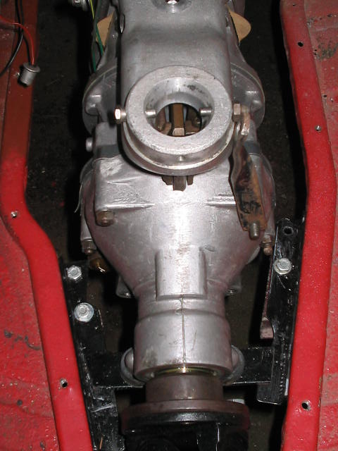

hi there, people again i do need lots of help. i finally installed the J-TYPE overdrive on my TR4A (I intend to share pics) and now i´m dealing with the installation of my dellorto carbs on my TR4A. i paid more then $350.00 for my intake manifolds cannon and the linkage sys ... and now the surprise that the linkage does not fit to the accelerator pedal, and its originally for a 1500 tr and mgb.
does anyone out there have pics of a set of webber carbs installed on a TR4 or TR6 please let me know.
