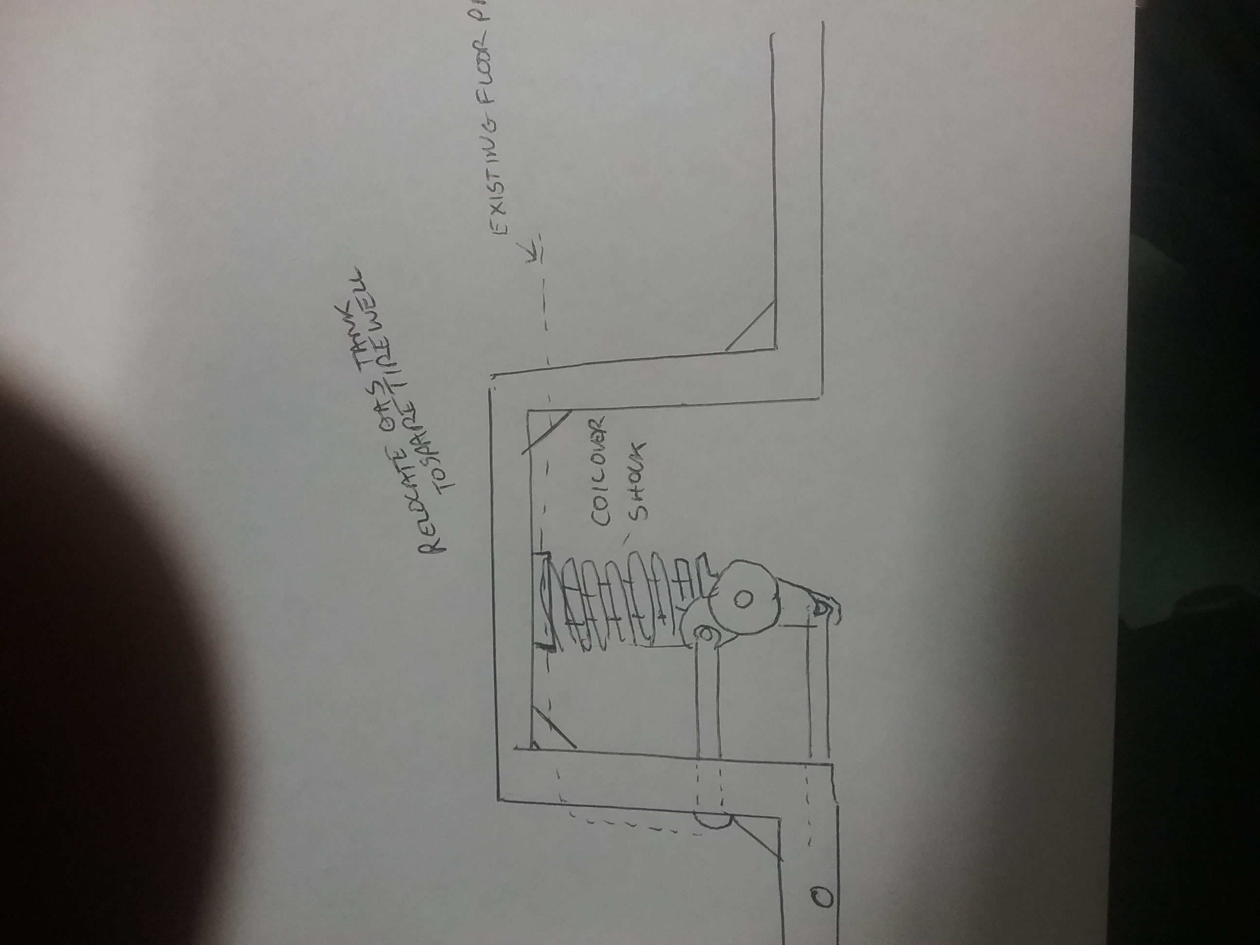

What I always wanted to try was with a TR4 frame and a narrowed and redrilled Dodge 8 3/4 rear with posi. 4 link kits are available along with some basic specs to follow. Please excuse the crude drawing.
