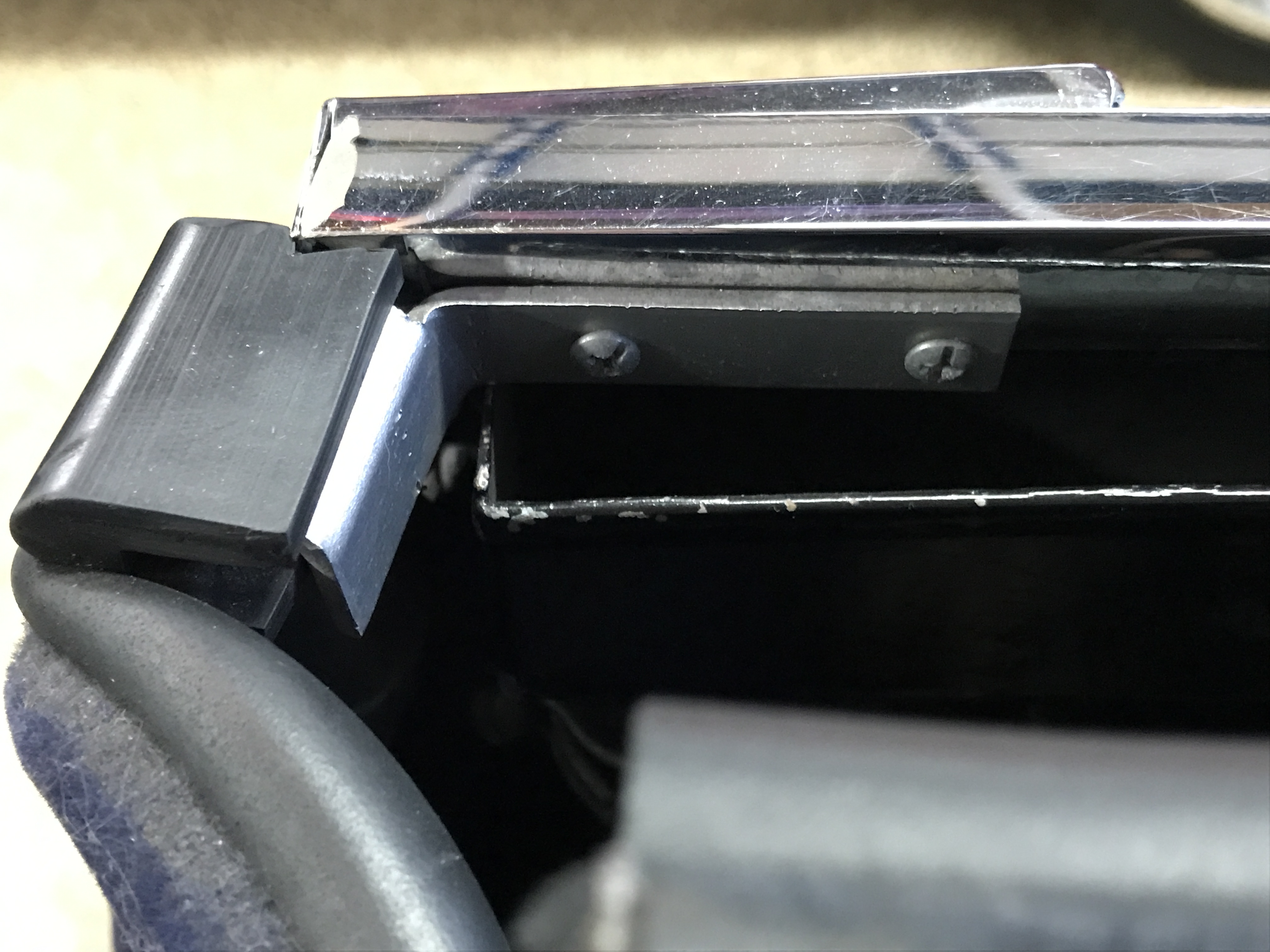

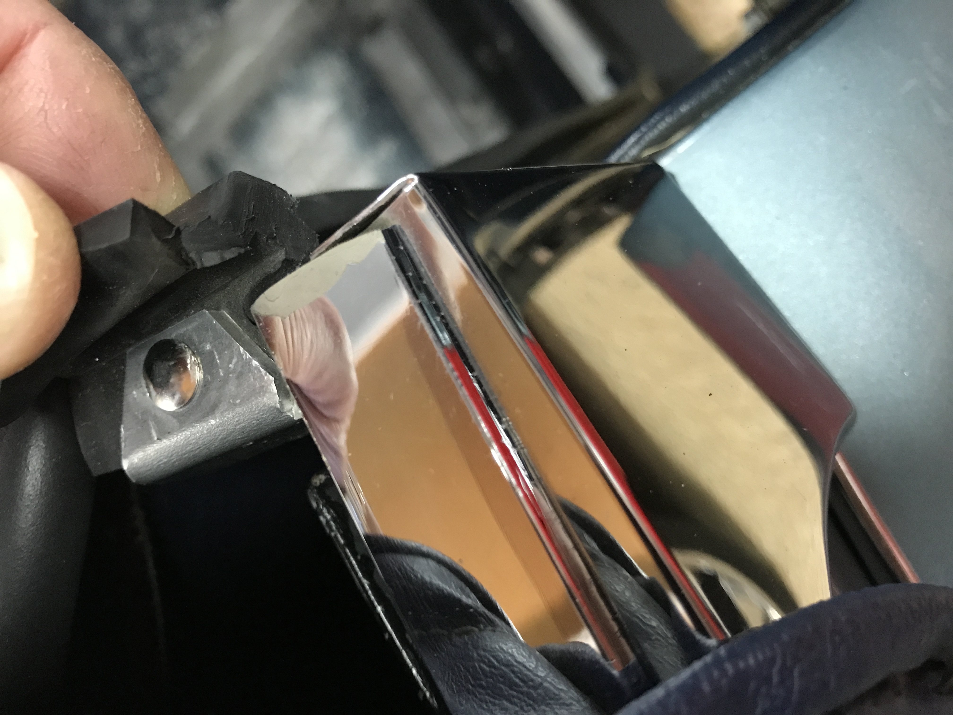

It seems that a photo might help. In this image, the driver's door is the bottom left, and the left rear fender is the bottom right. The odd-shaped shiny thing in the middle of the photo holds the piece of rubber in question. There is a split rivet through the middle of it, and underneath is all that remains of the rubber bumper, which once existed on the top side as well. The bracket is attached to the chrome piece in the lower right by 2 small screws. The exact thing, in mirror image, exists on the other side of the car. I should add that this is a 1967 model, and this part might or might not exist on older BJ8s.

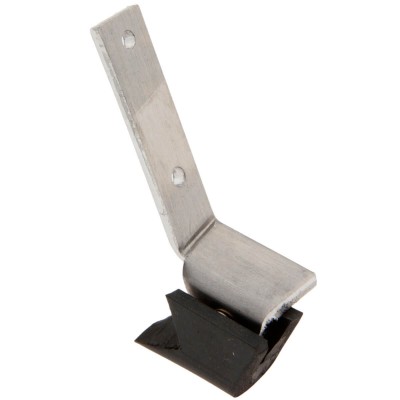

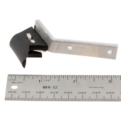

Hello James. Those are Shut Pillar Seals. As a unit (aluminum arm, rubber buffer and rivet) Moss sells #803-875. Two photos attached from Moss site.
The rubber buffer is the same as used on the front rain rails, Moss #031-359 about $1 and as you pointed out, the wheel arc buffers.
I used these and cut them to custom fit.
I used a rivet with a washer being I have rivets, vs using the split type washer which is correct.
I believe the purpose of that rubber buffer is to make a seal. You may find bending the arm to position it for best fit maybe helpful.

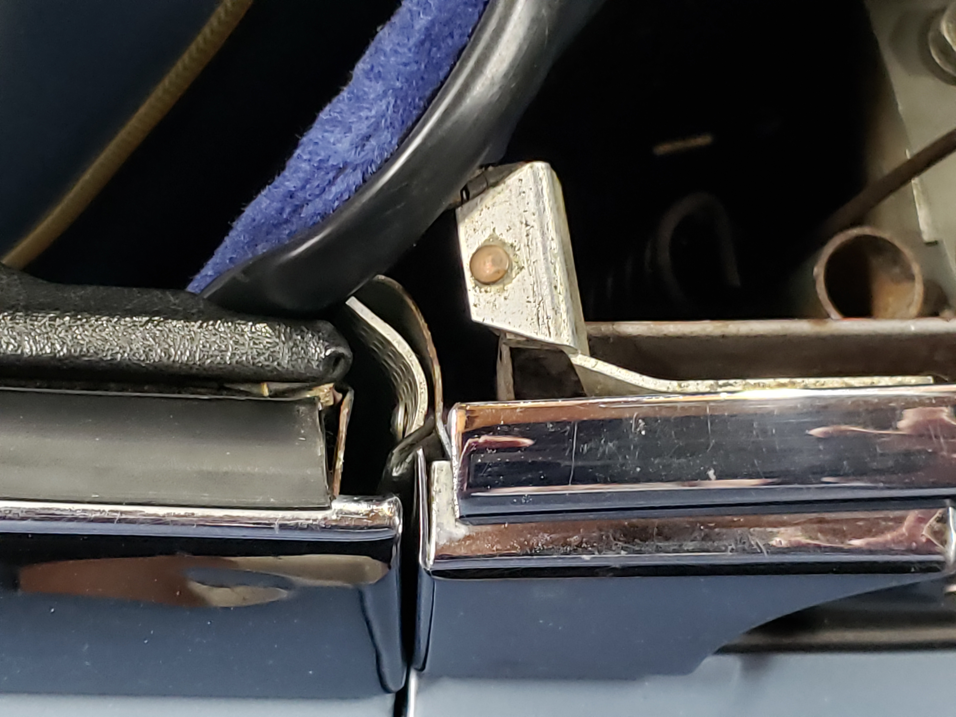

Anyone got a shot of how these are affixed to the car? A couple screws, obviously, but to which part of the body (shutpillar, hood enclosure, etc.)? Sheet metal screws, machine screws, bolts?
