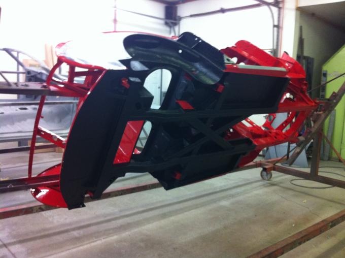

If you're not a purist, you may want to consider doing what I did to my superstructure on my recently sold 64.
The car was Colorado Red. Red is the most expensive paint colour due to all the pigments used to make it; so my painter told me.
So I had him coat all the vulnerable areas on the frame etc. with a coating which is similar to pickup truck bed liner coating.
