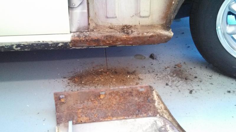

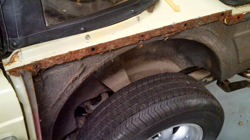

I would not risk it. I spent last winter taking the fenders off a car that I did not want to re-paint, but the rust in the seams was getting bad. It had been painted twice and there was very little rust anywhere else. The rust starts from within and then ruins a good paint job. It's time well spent and peace of mind knowing the joints are clean and sealed. Also, the lower part of the front and rear fenders that overlap the rockers, collect dirt and you will get rust through. It's not a matter of IF but WHEN it will show up.
I agree, even if you paint it as a put together body you should have it apart to clean out the flanges and other concealed areas and put at least some epoxy prime and rattle can on it to seal out future moisture. Otherwise you risk a couple years down the road seeing bubbling and the need to take it apart and do all that anyway. Better to do it up front and know what you have once color goes on.
