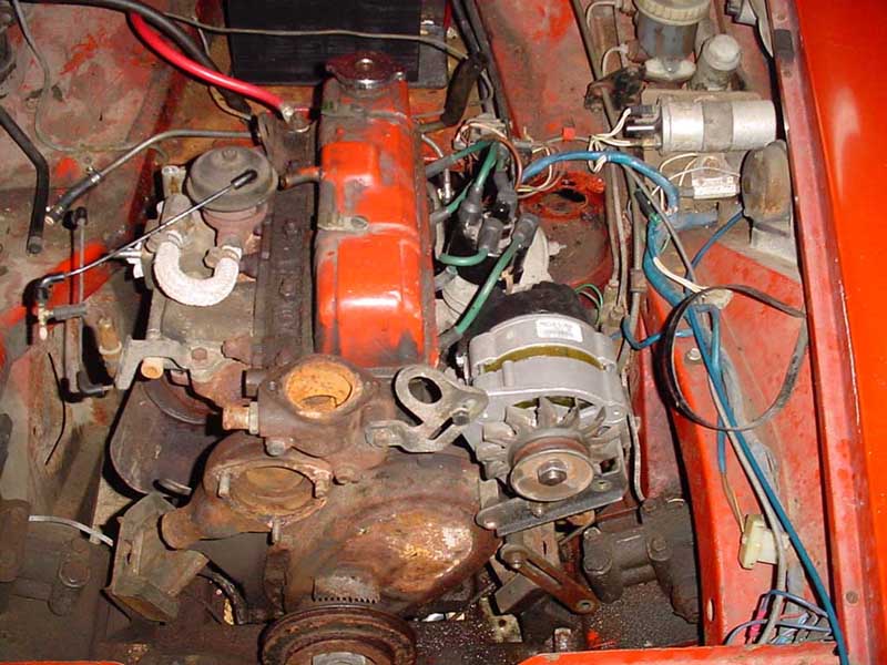

Hi Jim, I'd have to agree with JC, I run mine at 12 degrees before, and I'd be surprised if things were running as well as they are if they are off by 90 degrees. For what it's worth, I found a picture showing the wire routing on my car. If the picture doesn't make it, I can describe it. Standing at the left side of the car looking down on the distributor, #1 is at the 8:00 post, the firing order is 1-3-4-2, and the rotor is turning counter clockwise.

Here's the picture. Had to make it a little smaller first.
-Dave
