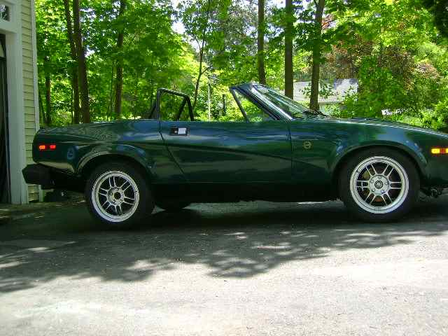

The clear winner for a lightweight, strong, low cost wheel is the Enkei RPF1. A 15X7 is 9.7 pounds and around $175 a wheel. I run the 16X8 which weigh in at 13.2 pounds each on my green car. Unfortunately they don't come in a 4X95.25.

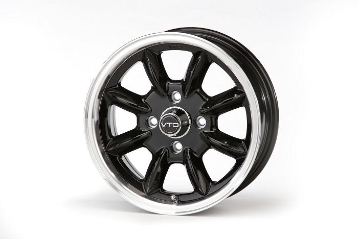

Hey guys, I closing out Superlites now, we started making our own wheels, so if I have any size for you, which I do have some 15x6 TR2/3/4/6 wheels left for discount prices, and other Superlite size, that may appeal to you as well, I sold the wheel on the Green TR8 above, if I rember correctly they were 15x7 fornts and 15x8 rears. I also have the new wheel (VTO Classic 8) in black and silver center for the TR 2/3/4/6 15x6, here's photos of them. Give me a call if any of this interest any of you.
Here's a pic of the silver 15x6 in the new VTO Classic 8, right now we have the 15x6 for MGB and TR2-6, coming next is the 14x5.5 (MGB etc.) and 13x5.5 (Spitfires, Spridget, etc.) they'll be available in the Classic 8 and the new Retro 4, which is modern remake of the American Racing Libre, other sizes will trickle into our stock between now and fall of 2010, our primary market is quality wheels for classic cars. I had a little say-so in the making of the new wheel, for instance I wanted a shinier machined outer rim that more resembled a hand polished outer rim and from the pictures you can see we acheived that, also weight was a big concern, our new 15x6 weighs 13.7 pounds which is almost 4 pounds lighter than the 15x6 Superlite and the same exact weight as Panasport's race wheels. Needless to say we're excited about our new wheels.
