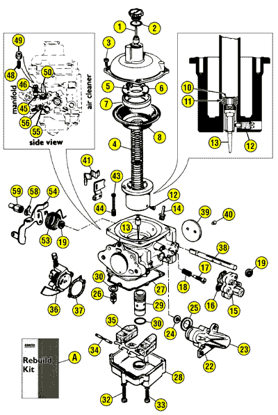

is the spring on the sjet supposed to move freely? mine is new and does not.is it supposed to be flush,slightly compressed or totally compressed?
1) fuel pump delivery pressure should be around 2~3 PSI max. Check that with a cheap pressure gauge.
2) float needle/seat could be mis-set or have some junk in them to keep them from fully closing.
3) Float height adjustment could be off or you could have a leaking float.
Let's get specific... which spring are you concerned over?
the one wrapped around the sjet.not shown in this diadram, but is inside figure 29.thank you DR.
