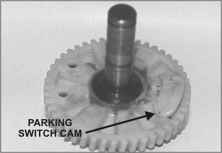

The wipers on my GT park on the passenger side. How easy is it to adjust them to park on the driver side? And if they park on that side would I need new arms?
Thanks!
danmas
Julian,
It's very easy to change. Just open the housing and pull out the plastic drive gear. Pop the parking switch cam out of the holes it's in and put it back in the other holes. See the attached picture for details.

That *does* sound easy. All I need to do is find the housing, but I'll look in my Bentley book for that.
Platinum
Passenger side footwell. Contort yourself so's you can look "up". Your car may still have a cardboard trim bit under there to cover it all up. But it's under the dash held in place with three bolts, some wires and a mechanical drive cable to the wiper arms.
