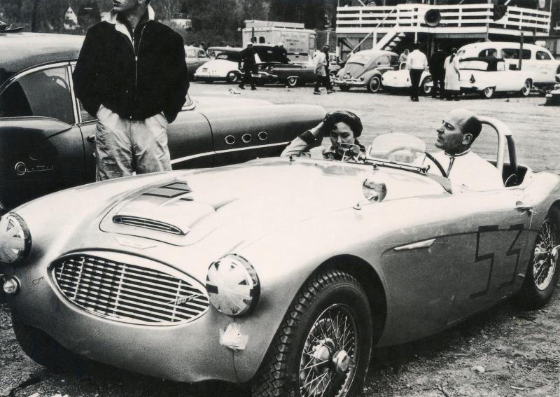

My wife and I were in NY last week visiting our daughter while she interns at an art and fashion publication in Manhattan. While the girls were shopping, I took in some sites of my own. Early amateur sports car racer and famous NY restauranteur Vincent Sardi was well known to drive his 100-S to work through the theater district, before he "traded-up" to a '57 100-6. That's what I'm talking about.....
