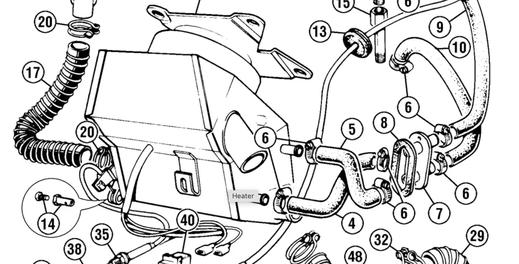

I have a 1973 TR6 that has a coolant leak inside the cars passenger side compartment. Is there a coolant connection inside the compartment space? Thanks for any thoughts or suggestions.
Gliderman8
There are two small hoses under the passenger compartment that connect to the heater core. Check there.
Here's a diagram of the heater hoses. Check #4, #5, and #7 which is a metal manifold that the hoses connect to; it can rust and leak.
These hoses are under the passenger side agains the firewall.
