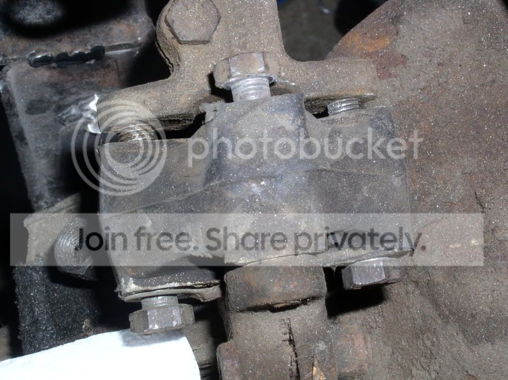

Think this was helping her steering response?
tdskip
As I bought her...
The PO really had a screw loose :yesnod:
Scarey Eh!
Cheers,
Tush
Yeah - that may be the least of your worries!
Nice! Good ground for the horn too.
I'd recommend replacing the lower coupler with the metal one from a TR6 if you can find a good used one and are not at stickler for original. I believe you may have to use a TR6 lower steering column shaft as well.
Scott
Oh my.....that is NOT good...lucky you found it, before it found you up against a pole or another car.
You didn't buy the car in Puerto Rico did you, from someone that Dale knows only too well?
