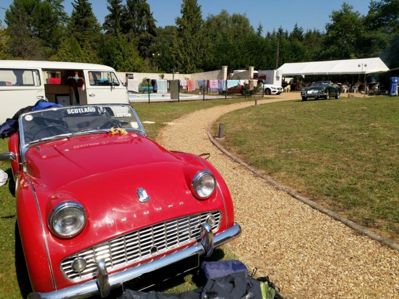

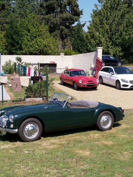

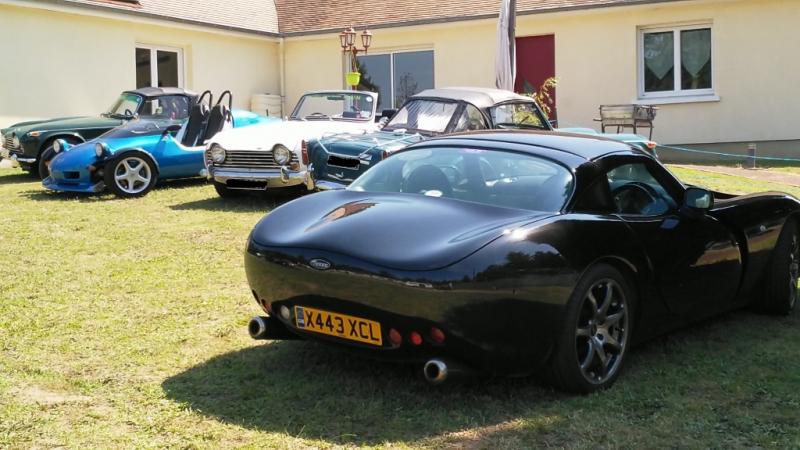

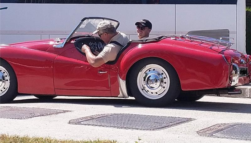

Got to Le Mans, attached a few pics of the cars in the group. The TR3 owner very kindly insured my son on hsi car for the trip, so he was able to get a couple of long driving stints in which made it all OK. Very hot weather so we had several incidents - ended up at French scrapyard next to the circuit looking for a relay.
Also have an old TR3 loom which I can strip for the right coloured wiring if necessary.
