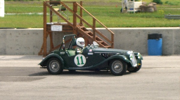

While at a local track recently, I saw a supercharged MG-TF.
The supercharger was from a Thunderbird SuperCoupe. I don't know if the output would be enough for a 6 cylinder, but it might blow a 4 cylinder and the blower should be small enough to fit into the engine bay.
The MG logo was taken from a key fob, curved, and simply glued onto the blower snout.
All of the interface brackets were made from 1/4" aluminum plate.
Tim
