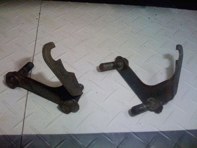

Does anyone know the size of the mounting bolts for the front disc calipers? Moss doesn't seem to list them. Jim
I found this in a parts box. Looks like the caliper mounting bolts because of the tab washer. But don't recognize the bracket? Anybody?

Position and holds the brake hose in correct orientation, when used with the banjo bolt.

Everything in your photo is all you need to install your brake calipers. The brake hose support brackets positions your brake hose correctly to prevent binding. Torque your caliper bolts 45lbs with a little blue loctite, you will be good to go.

Thanks for the help. Back to the garage.. Jim
