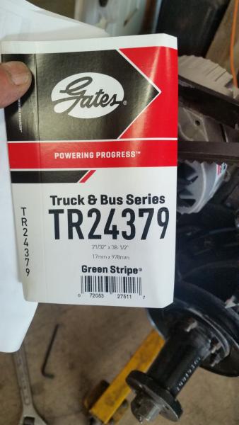

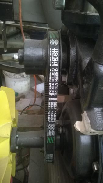

Hello Billy
This is what I have on my TR3 motor. Is fitted with an altenator so the belt may be a little short.
On the belt it has TR24379 Green Stripe 11 Belt 17A0960
David

This week, I had to replace the fan belt on my 1960 TR3A. The belt that failed was marked "Gates 17A0960". According to Gates, it had a 17mm top width and 960mm outer circumference and cross-references to a Gates 24379. I replaced the failed belt with a Napa 25-24379 (made by Gates) that I'd been carrying for a few years. It wasn't easy to install, but I got it on with some effort.
Today I bought a new NAPA 25-24379 so that I'd have a spare. I was surprised to find that it is different than the old 25-24379.
The old NAPA 25-24379 was marked as 3/4" (19mm) x 38 1/2" (980mm). The new NAPA 25-24379 is marked as 21/32" (17mm) x 38 1/2" (978mm). Both are made by Gates. That's not a huge difference (less than 1/10" in both width and length) but I didn't want to buy a belt that might be even harder to install.
I called Gates. Their customer support line recommended Gates TR28386 (20mm x 980mm) for a TR3A. Many TR owners moved to 24379 because, being narrower, it was easier to fit than the 28386.
I asked Gates if a 17,18, or 19mm x 980 mm belt was available since that might be easier to install. They don't offer 18 or 19mm widths. The closest sizes that they have in 17mm, apart from the new 24379 are 17x961 mm (shorter than the 24379) or 17x1017mm (too long).
I don't know if being 2mm shorter will make the new 24379 harder to fit or not. However, it (along with the 28386) are the best choices offered by Gates/Napa.
By hard to install I assume you mean getting it through the space between the pulley and the drag link? In case you do not know, turning the wheels full left or full right should open up that gap a bit, possibly enough.
One can also shim the motor mounts (or perhaps replace them) to gain some clearance. I added shims on my TR4 since R&P steering means the gap does not change as the wheels are turned.
In 2008 I replaced my belt with the NAPA NBH 25-28386. This is the recommended belt for a 1966 TR4A by both Gates and NAPA. I don't recall issues getting it around the fan or fan hub (I may have jacked the motor) but, it was very tight to get over the pulleys. This was with the generator adjustment fully slack. Once installed, I only had to move the generator 1/4"-1/2" to tension the belt. It seemed to me I could have used another 1" in belt length. Specs on the NBH 25-28386[FONT=&quot][/FONT] are 39.17" x 0.875" (995mm x 22mm).
Bob
Don't know as the motor is still on the floor not in the frame. As far as I know that is the way it came out but I have added the yellow fan.
Is there something I should know about that fan?
David
...I have added the yellow fan. Is there something I should know about that fan?
Clearance (gap between the fan and the radiator) is sometimes an issue with that fan. On my TR4 (which is admittedly different from a 3a) I had to install it backwards and use a spacer I cut from a plastic cutting board to get it in a good spot - yet I have seen some that required no such measures.
Just something to keep in mind once the engine is in and you offer up the radiator.
Thanks for the heads up on that. Have a old style radiator with the crank hole that I had pressure tested. Don't want to damage that.
David
