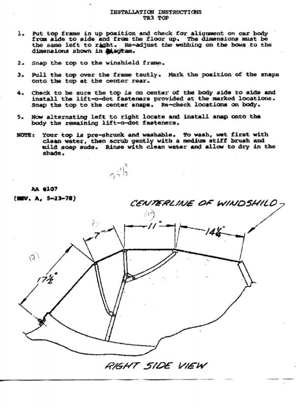

I followed the directions in Roger William's book "How to restore Triumph TR2, 3, 3A, 4 and 4A.
Pages 188 - 191
He starts at the rear getting the top centered and works out from the center. Alternating LTD fasteners from side to side. Work in the heat so that you can streach the hood more easily.
Having completed the 12 fasteners across the back move to the front.
He says to have a helper to stretch the hood as you mark.
It worked for me.

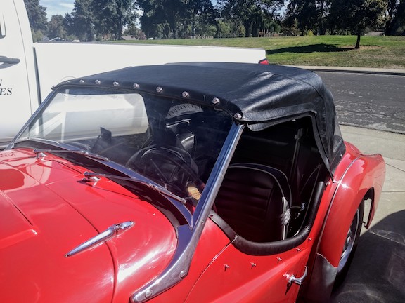

I now mount the top by poking holes in it and just hook the bare holes over the studs. When all looks good, I take it off and install the dots at the holes. This way little is lost if you make a mistake or get a pucker that requires a small adjustment.
All good suggestions. What I did was to anchor the front two corners to the windshield using Johns poke the hole method. Then went to rear center and am working my way out. SO far it seems to be working well.

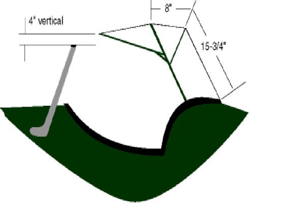

When I set the straps for the recommended spacing of the sticks, I do not get the recommended 4" above the windshield. More like 2-1/2".
Decided to finish the top this way and then see if I need to adjust the straps.
Steve
I do not know about the 4 inches, and I think the ribs finally adjustment can be made later. When I set the ribs up, I open them up and then fully extent them, but leave the last rib floating and never screw the last rib down to the cloth. I pull the ribs into position so the sewing on the top is lined up with the ribs. Then anchor the back straps, when the lines of the top match the ribs and everything looks correct.
I need to check my frame dimensions against that drawing. I Adjusted the frame till it aligned with the seams in the hood.

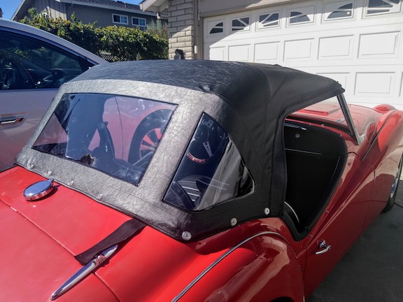

I agree. I've run across at least two different diagrams of the rib settings, and my final version didn't correspond to either of them. HoodInstall.jpghood sticks.jpg
I'm pretty happy with this.
The final frame dimension were 15-1/4, 7-1/2. The front bow could stand to be tighter. When I push on it the wrinkle over the door goes away.
This could be because the frame is old and worn. I'm thinking of putting a rubber pad on the linkage where the frame bears.
Still need to put on 2 lift-a-dots and trim the straps.
Thanks for all the help and encouragement.
Steve
Looks great.
The sun will help tighten it up.

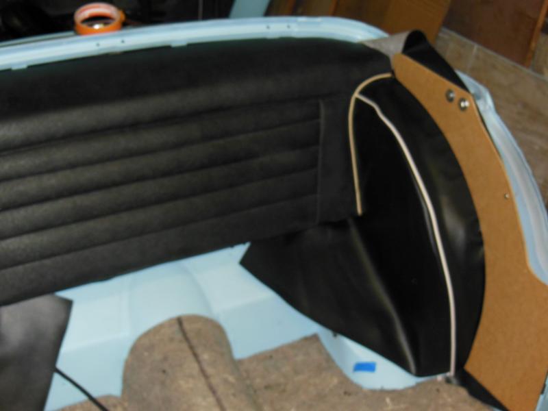

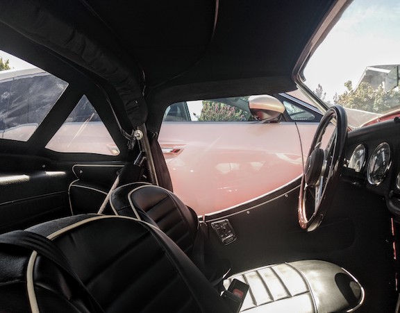

Top looks like all the ones I have done. I like your seats and white piping. The project I am doing now has the white piping. The white piping sets your car off well plus the deep pattern in the seat looks very original. I have an original back seat with a deeper pattern but my seats and wheel wells do not match. tried to post a picture, but no go.
When I bought this car, the seats, carpets, door panels, vinyl, etc. all came in boxes. Now I just have the side curtains to do.
I was lucky that the DPO had good taste.
An added tip when punching the holes for the Tenax snaps is to use a slightly smaller hole size than what the Tenax measures. You can force the tenax through for a tighter fit and that will eliminate the hole from stretching out wider than the Tenax snaps when putting the top on later when the top has shrunk or and when it is cold and the top doesn't want to stretch as much as when warm.
Heck you live California, so maybe you will not the need the side curtains much; it is pouring here. I have an original back seat with a deep pattern but my seats and wheel wells are not as deeply textured and it kinda bothers me, but I used different vendors because I am cheap and the seat should hide most of the side. I am going to glue the wheel wells right to the metal because that is the way I came, I believe; they are not glued yet. Is your texture pattern on your seats as deep as my picture of the back seat?
I talked to Basil about not being able to post and it looks like my new camera I bought overseas had too many MB. I sized it down but not sure if the vinyl pattern shows will or if the picture is too small.

Looks like a great start on the interior.
I was not happy with my wheel well covers becase I did not pad them enough. You can see the edge of the seam through the vinyl. I recommend 1/8" foam rubber.
My seats are not that deep, nor is my back panel. My feeling is that as long as it is all black, it will look great. You might see the flaws but no one else will.
That's the problem with doing your own work. Your eye is drawn to every mistake you make. Live with it.
