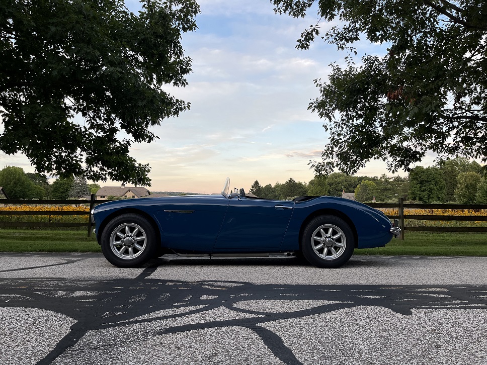

I'm not sure what possessed me to check this thread (or even remember it existed) but the Healey is all done and we've been enjoying it the past few summers. I continued the build thread on the Grassroots Motorsports forum for anyone interested in the detailed process.
