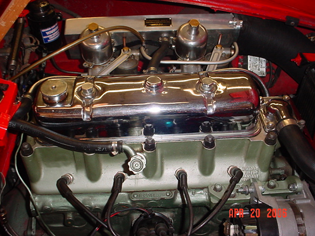

Does anyone have a diag or pic of how the vent lines return into the 100M air box ?

Ian,
See the attached pic. The vent lines are just a short straight run from the carbs to a couple of holes in the air box. I've already mentioned the banjo sealing washers.
The lines were originally sealed to the air box with rubber grommets that were shaped sort of like "Hershey's Kisses". Any grommet that will fit & form a reasonable seal will work.
You could fill the vent slots on the one lid with a good epoxy such as "JB Weld".
