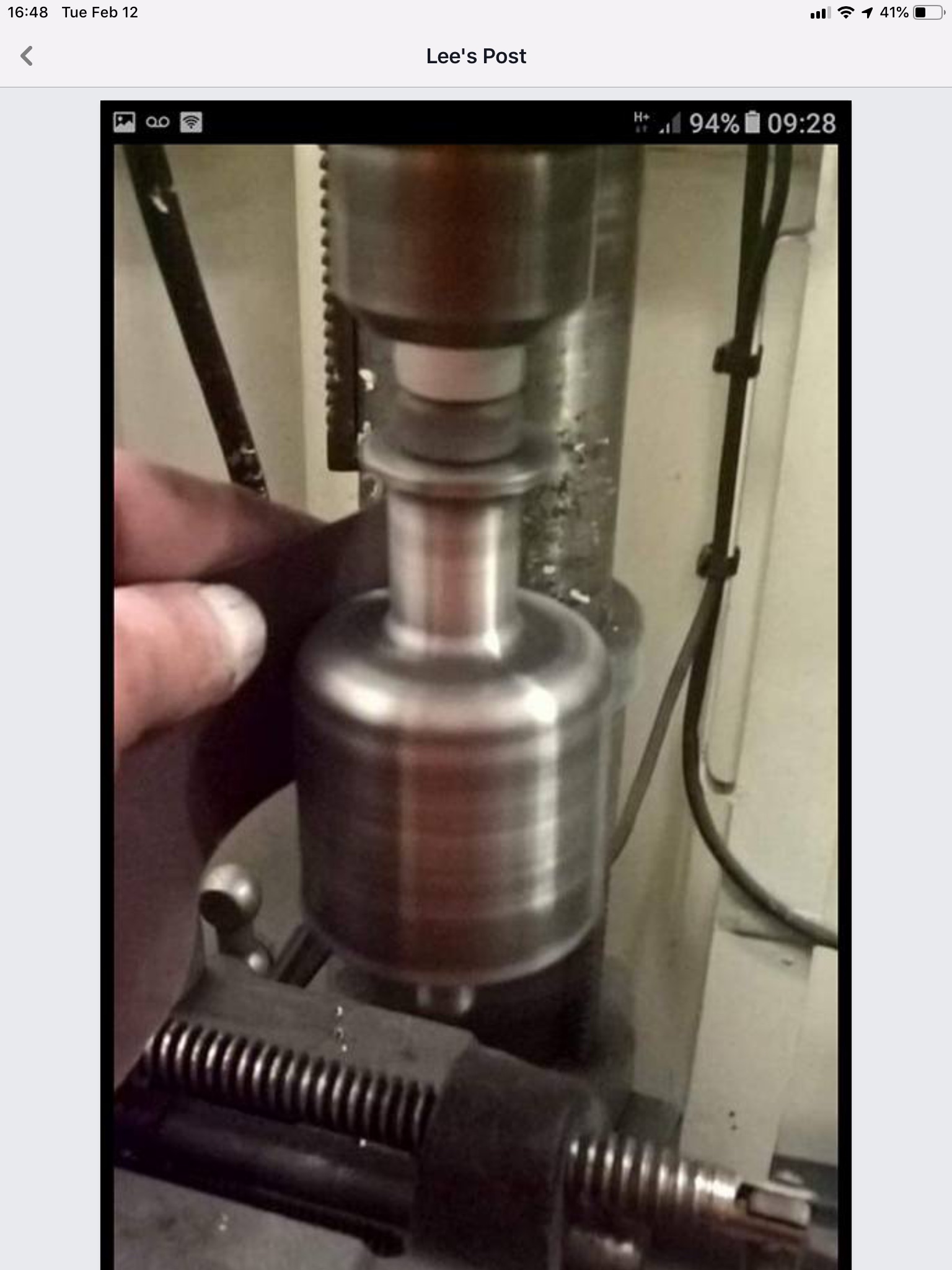

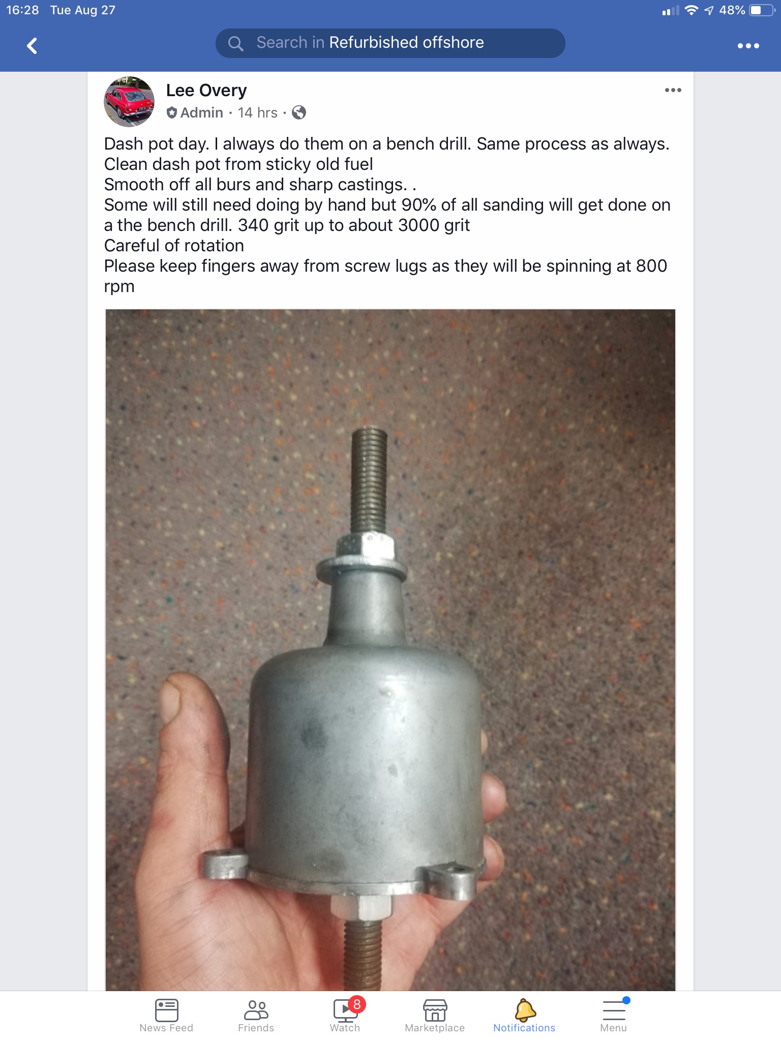

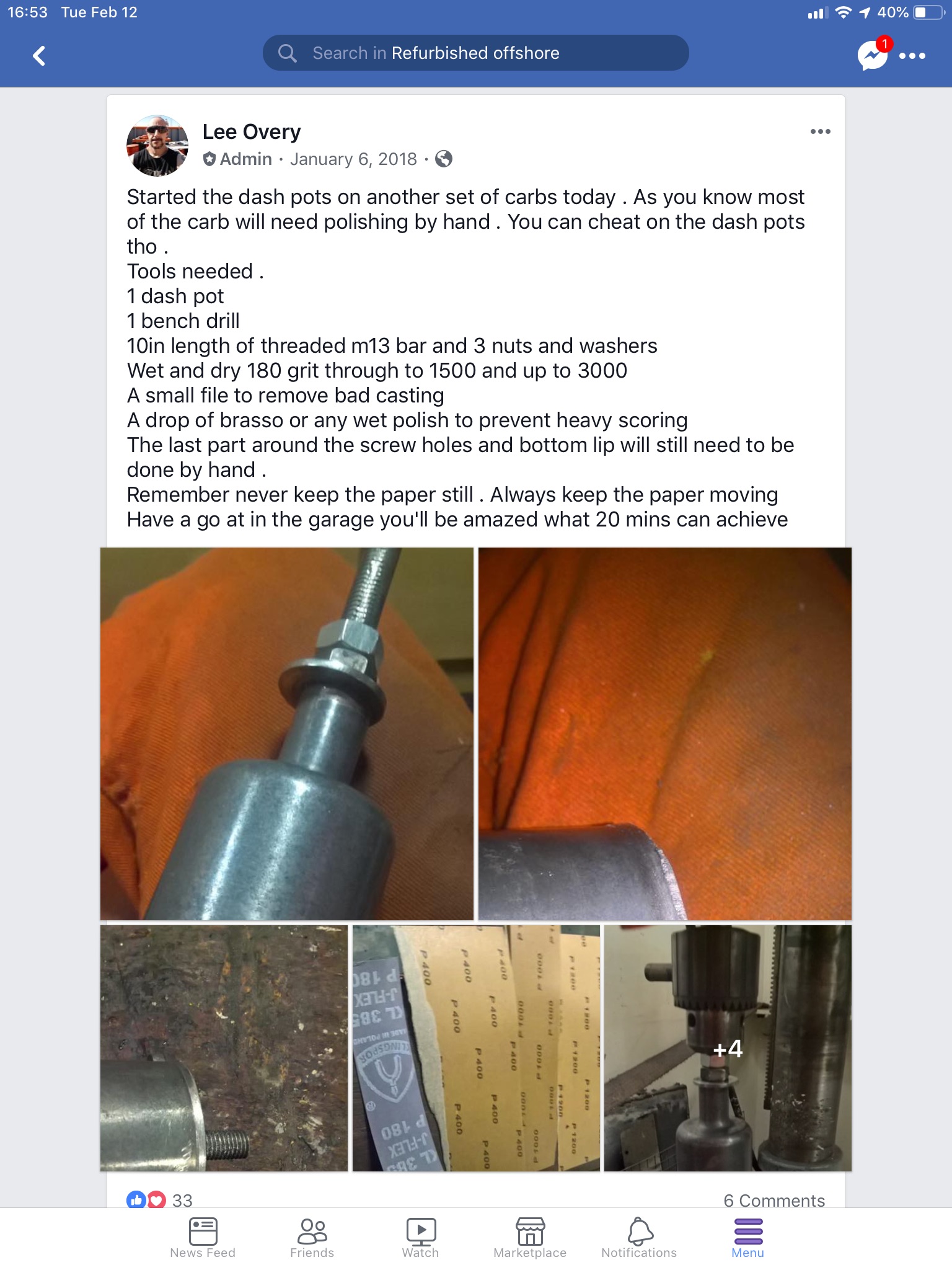

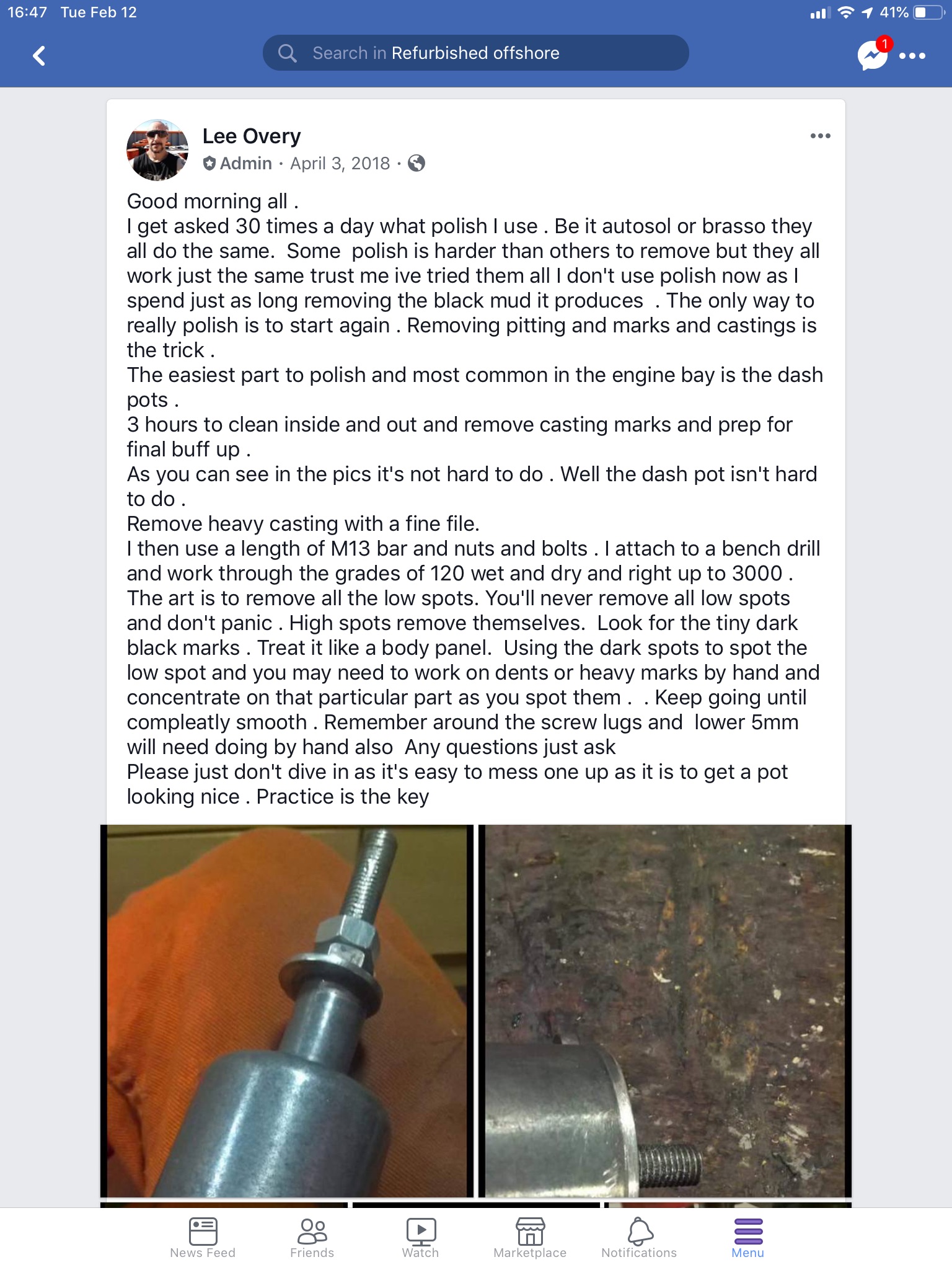

This is a way to polish the SU Dashpots.

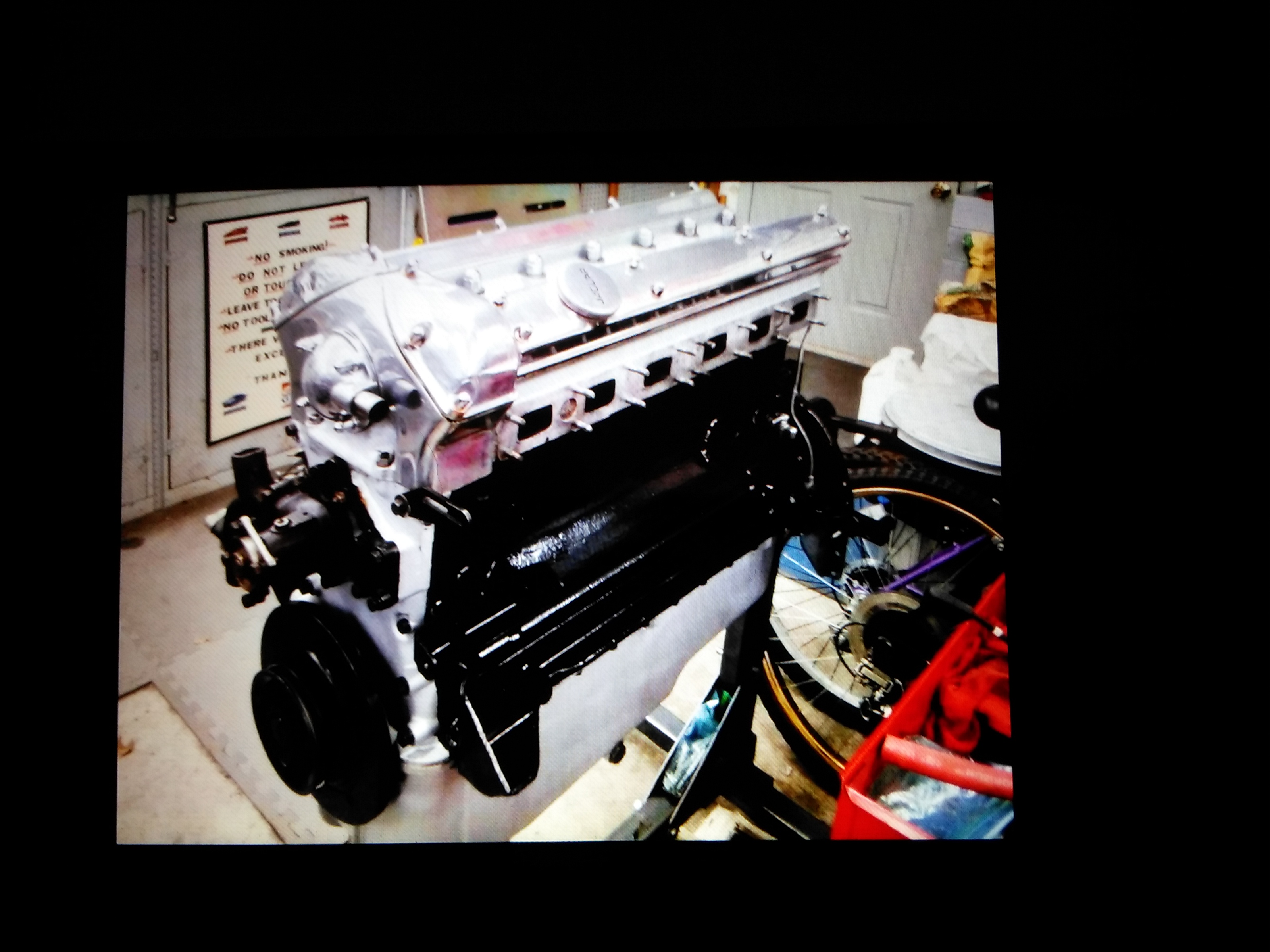

LarryK
My lump after rebuild.
