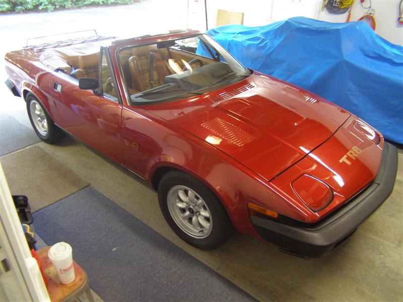

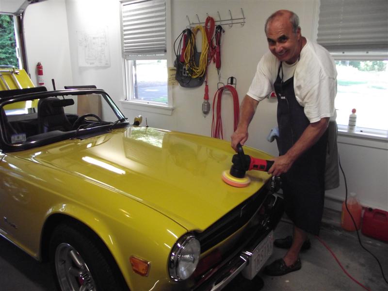

From my prior life I was taught how to use a high speed buffer to cut down lacquer, as well as to bring enamel up to a high gloss. Both of those, as well as clear coats can be very easy to screw up, even if you know what you are doing and have the right pads, compounds, etc.
This fall I bought a Griot's garage R/A polisher and couldn't be happier with it and the results that it brings. I knew it was expensive, but I considered it as a investment in a tool for life, as they are extremely well built. And I also considered the cost of a paint job and that swayed my decision to go all the way with the 6" polisher and their line of polishes. You actually use very little polish and wax to bring a paint finish up to showroom standards, because it's all in following the guide and letting the machine do the work for you.
It actually improved the finish on my TR6 and TR8 and neither were too shabby to begin with. I am VERY pleased with the products.
If you look at these pictures, you can see everything around or above the cars reflecting in the paint after the Griot did it's work.

BTW, on that top TR6 picture, you can see that I'm using the orange pad, which is for the polish and that was the finest grade, #4. I didn't have the wax on the TR6 at that point in time.
The TR8 is waxed (after two complete polishes, #3 & #4) in the bottom picture.
And I did buy the bonnets to fit over the buffer to remove the wax. If you follow the DVD instructions and use the wax sparingly, there isn't much to remove, but by using the bonnets, it is soooo easy and it shines so well. One quick wipe with the micro fiber towels and it's showtime.
