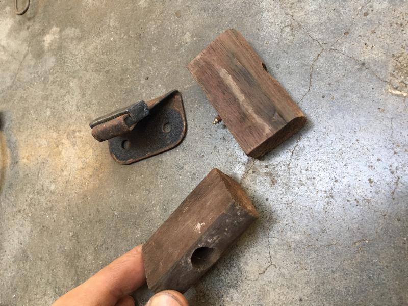

Can anyone tell me what these are and where they go? All 3 pieces. I am stumped. Thanks

The metal piece is the center windscreen bumper, to restrict it's tendency to blow back in the center. The wood blocks support the tops of the quarter panel capping, or dog leg capping.
Ah, the metal piece attaches with the mirror. For the wood blocks, I will have to take a look to see where it screws into the car...I don't recall seeing a pilot hole in the top of the quarter panel of the car, but then again I wasn't really looking too hard there. Thanks. for the quick reply.

They are dark, but the blocks go at the top of the dog leg edge behind the doors.

@John, thanks for the pics. I found the hole in which the screws to the blocks go into. It's all starting to make sense now :smile:
