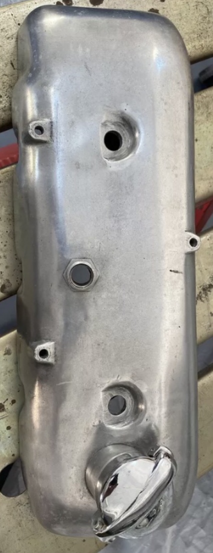

Does anyone know if these rocker / valve covers are standard or after market accessories

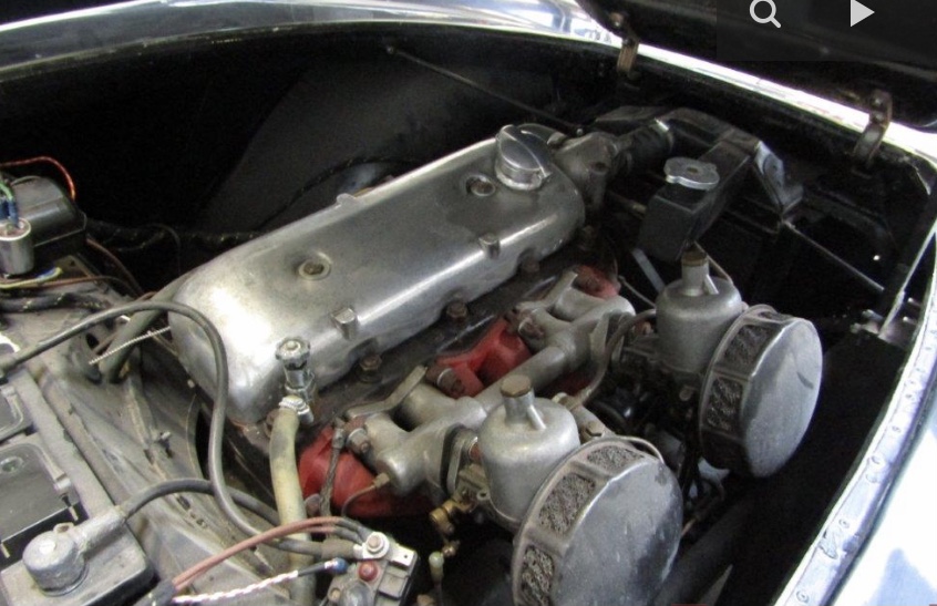

could be Standard Triumph era
Or swallow Doretti ( that’s what the under hood/bonnet pic I found)
I have taken a chance on eBay for my 3a as it looks period.
help welcomes what would the 3 holes be used for ?
2 one side one the other
if it fits I can block these up.

It's not Triumph, but it looks like it will work. You will need a vent in the cover, as the Triumph uses a road draft crankcase vent system, which needs to suck in the valve cover and out of the draft tube on the bottom rear left side of the block.
